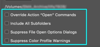

Here is a screenshot of how I'm setting up the batch (FYI, I have my save command built-in to the action, hence no destination selected):

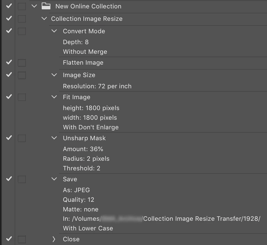

Also, could you share a screenshot of the Action you're running?

Thank you, Sahil. Yes, I have tried each of those options individually, still having the same problem.
Here is a screenshot of my action:
