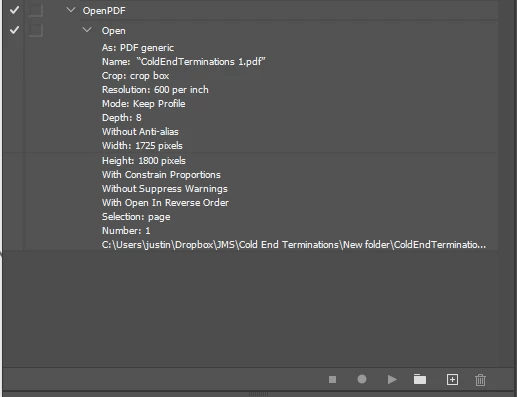

    If you individually open a pdf and step through the action, what happens? You can double-click each step to perform it in order.
    March 16, 2020
    When I open the file individually, I get a dialog box with the correct dimensions already set. When I automate I need to supress that box and automatically set them to the size specified in the pdf. The automation process seems to use the dimensions of the first file to determine the dimension settings of the following files.

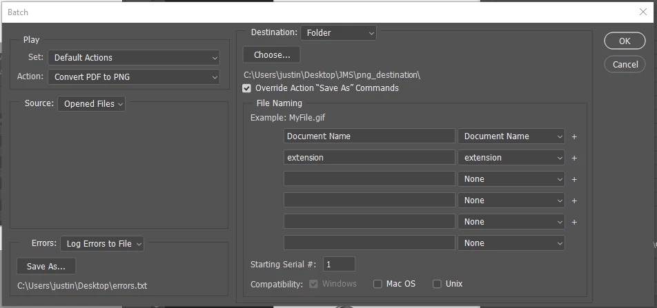

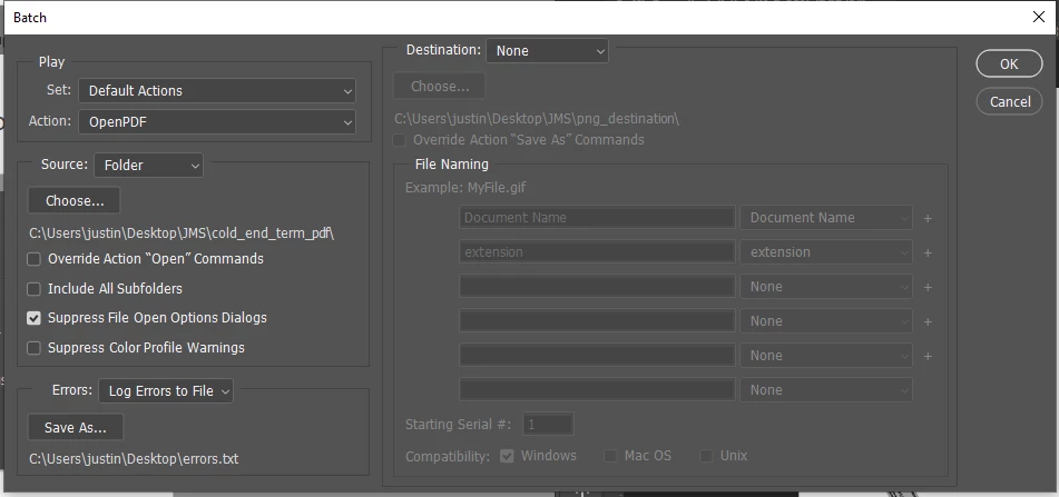

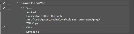

    I actually did this in two steps. One action opened all the files. The second iterated through the open files, saved the png and closed the files. I found that when I did it with one action it kept saving over the first file. The action setps and automate settings are below.
    Open:
    Batch Settings
    Save PNG
    Batch Settings
