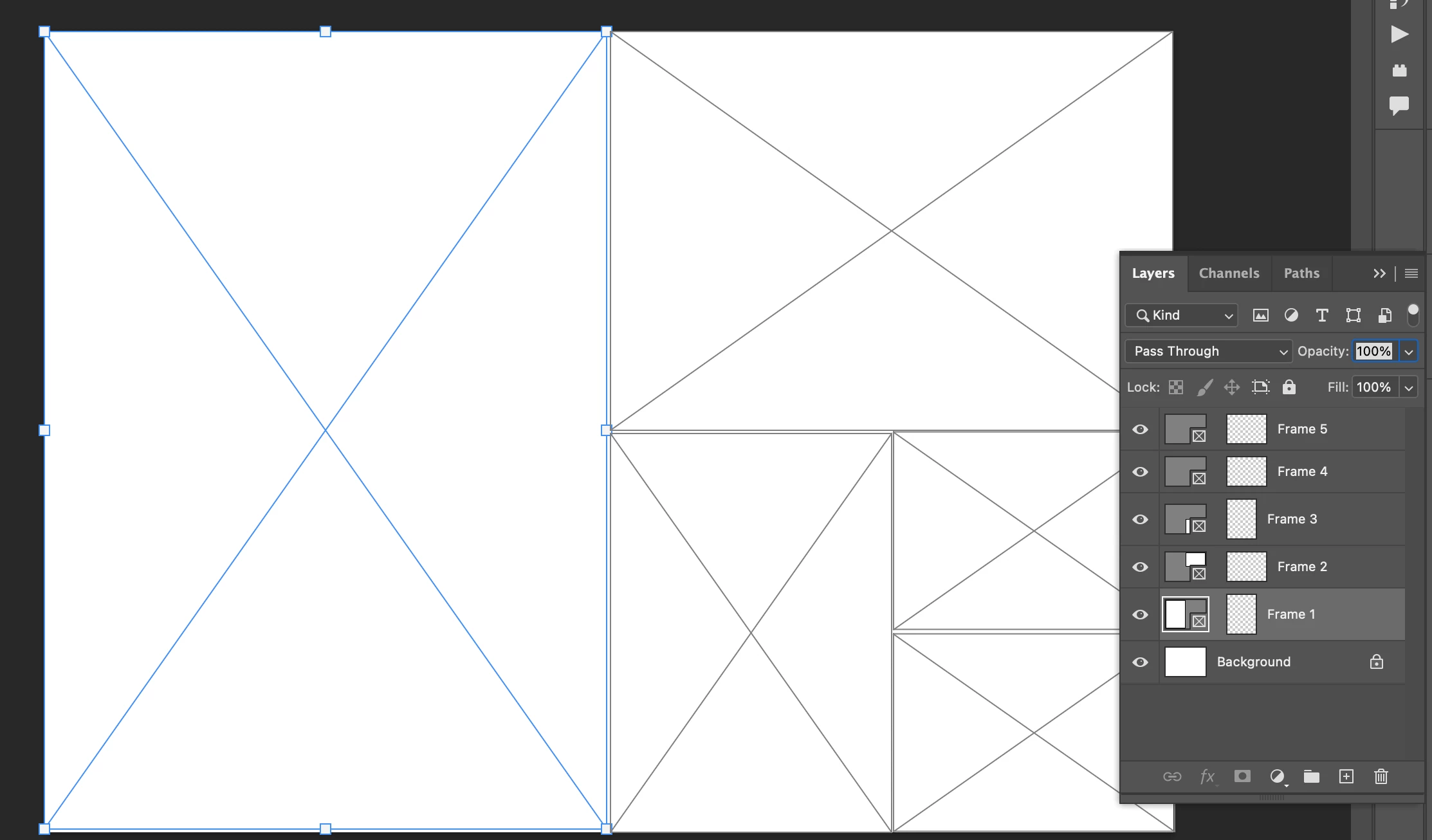

I have created a template with the different sized frames as holders.

I am now getting the following error after selecting to run the script under File, Scripts, and the input folder name. I have Adobe PS 2024 25.4.0
I didn't spot this before in your screenshot, see the notes of the various conditions that need to be in place:
* There must be existing linked smart object images in each frame
and
* All files must be the same pixel width and height - and the same PPI resolution
* There must be a layer named 'Frame 1' containing a linked smart object
* Remaining frame layers must use the same linked smart object as found in 'Frame 1'
The frames can't be empty, there needs to be an existing placeholder image in all frames for the replacement to work.
P.S. The script could have the required template name changed from 'Picture Package Template.psd' to 'A5_Jumbo_A7_A8 template.psd'.
I'm guessing that the previous code was fine, it's just that there wasn't an image to swap!

I can think of ways to do this with Smart Objects (each image size is a copy of the same linked Smart Object so replacing the linked file in one updates all of the sizes on the layout), but that would be inefficient to do by hand with 1000 images, so would this be a good way to use Photoshop variables? (Photoshop data-driven graphics)
I haven’t actually tried this, but because each image on the sheet is a layer, could each layer in one layout be associated with a spreadsheet field with the same JPEG filename in the spreadsheet, then you just hand Photoshop the folder of images and the spreadsheet and Photoshop auto-generates all the layouts?
Stephen Marsh
Feb 12, 2024 9:12 PM UTC
quote
I can think of ways to do this with Smart Objects (each image size is a copy of the same linked Smart Object so replacing the linked file in one updates all of the sizes on the layout), but that would be inefficient to do by hand with 1000 image...
By @Conrad_C
Conrad, this is exactly the method that I was going to explore via scripting!  :]
Stephen Marsh
Feb 12, 2024 12:21 PM UTC
Please provide a copy of the template PSD, or at least a screenshot of the layers.
It's a shame that Adobe never returned the Picture Package feature.
StephenC Photography
Feb 12, 2024 12:29 PM UTC
Thank you for your reply. Herewith a screenshot of the layers and blank template:
Stephen Marsh
Feb 12, 2024 12:47 PM UTC
There is no PSD, it would help if you could upload it, thanks.
P.S. Will all future images have the same pixel width, height and PPI value? In other words, is the input to the frames consistent, or will it be inconsistent? If the image input is consistent, what is the pixel width, height and PPI value?
