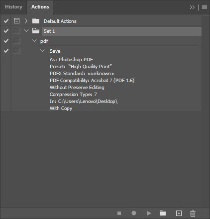

Do not touch filename in Save As dialogue when recording action to not record file name in action step. See step below to save as PDF and compare to your. Can you notice that I have saving location recorded but not file name?

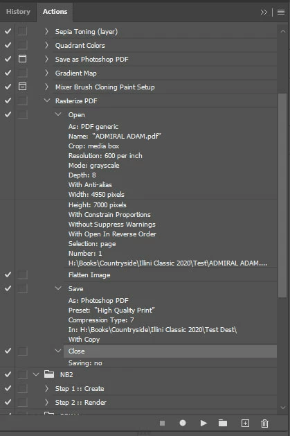

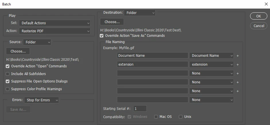

I believe I followed your instructions. When doing "Save As" during recording the action I did nothing in the Save As dialog--but of course the name of the file I opened is there in the filename field (should I have backspaced it out--you said "do not touch filename). Attached are screenshots of my Photoshop action and the batch process dialog. I'd like to get this figured out for the next time I get a job like this.
What results when I process the folder of PDFs with this action and batch process is one file in the Test Dest folder with the filename of the file I opened as the first step of the action.

You should batch using the override action save as command checkbox ticked.
