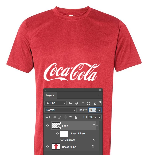

If I can understand your problem then answer is yes, you can automate a process using actions to some degree. You can not loop through all templates but you can place all 100 different designs into one template and save files. You must manually open another template to run batch again. Please read this thread where I have provided action and explanation for similar request How to fit image in particular frame?

I do not understand what you have written.
"I am using the actual PNG from the manufacturer since it replicates what the shirt actually looks like"
Are these PNG files from the manufacture an actual t-shirt image?  Or are these png files a designs you will be putting on t-shirt.
If they are design.  Do any of the png images  have any transparent boarders.  Pasting or placing png image with transparent border can be a problem if these transparent boarder are important for positing the design.  Photoshop Copy and Place trim transparent boarders.
Are the PNG Design the correct size for your  T-shirt templates and have the correct perspective and distortion for the t-shirt in you template.  I would also think if these are designs to placed on T-shirts placement location may well depend on the design content.  Centered on the the t-shirt  may not be good location for many designs.
Actions can not deal with well with varying sized and can not user logic. Scripting would be better choice for automation your process

Yes they are just a png file of the shirt fronts. An example can be seen below on our site:
https://www.chesapeaketees.com/tshirtecommerce//uploaded/Edited Images/Shaun and Lebowitz/All Sport M1009/Heather Red Front.png
I have all of these images at 1100 x 830 resolution and the designs I have not really toyed with yet but I am going to basically get those cleaned up by trimming them and resizing them with transparent backgrounds using an action. This will leave me with two folders , one with all the perfectly sized blank t shirt pngs and the other folder with the designs that are already perfectly sized to fit on the other folders shirt pngs.  When you say the correct perspective and distortion are you referring to making them look like they are actually on the shirt or are you referring to dimensions? If the first , you are right I would love to have that done but unfortunately I am not that skilled to automate that aspect. You wouldnt do side work would you lol?
