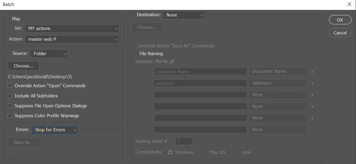

July 28, 2022
the batch process itself is just basic, like this:
however the action its playing is a bit more technical. In short its just resizing images and saving them in the same location using a second batch process to save within the action.
c.pfaffenbichler
July 28, 2022
»Include all subfolders« is unchecked, didn’t you say you wanted to process those?
Have you tried »Suppress file open options dialog«?
Anyway, I expect you will need to use a Script.
