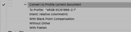

December 4, 2024
These settings work fine here and the resulting jpgs are sRGB:

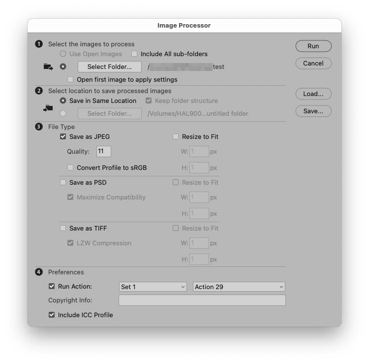

Thank you to everyone for the helpful replies.  I was finally able to resolve it by tinkering with the Color Settings, I changed the Working Spaces RGB setting, I cannot recall now what it previously was. It is now Adobe RGB (1998).  Then I re-recorded the Action and ran it through Automate-batch. It then converted the PSD's to jpegs and sRGB as I directed. However, I still have confusion over some color profile issues. The TIFFs I created for my client to print files from, I compressed with LZW in order to email them. When I viewed these files, there was a noticeable skin tone color shift from the PSD files which were also using Adobe RGB. However, the Jpegs look similar to the PSD's!  I wanted the images to resemble my PSD's for printing, is it the LZW which shifted the color or the TIFF's? (Why do my PSD's say RGB as the "Color Space" and profile as Adobe RGB, is my "Space" correct?) Also,
what is "without dither" referring to? I ran my files "with dither" because I didn't understand the option.  And, why did you not check the box to convert to sRGB, rather than running the Action in category 4 of the Preferences for the Image Processor?  Is there a benefit to using the Action? I also used the Relative Colormetric setting , but was advised by someone that using Perceptual was better.  Thank you for your expertise, so much appreciated.

Your description seems longish, but not completely clear …
Please post meaningful screenshots to illustrate the Action, the Image Processor settings etc.
