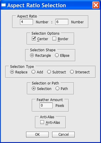

Step one menu File>Automate>Aspect Ratio Selection...

Aspect Ratio Selection  Dialog set the aspect ratios numbers like 4 6 order maks no difference
option center selection type rectangle replace any existing selection not path 0 feather

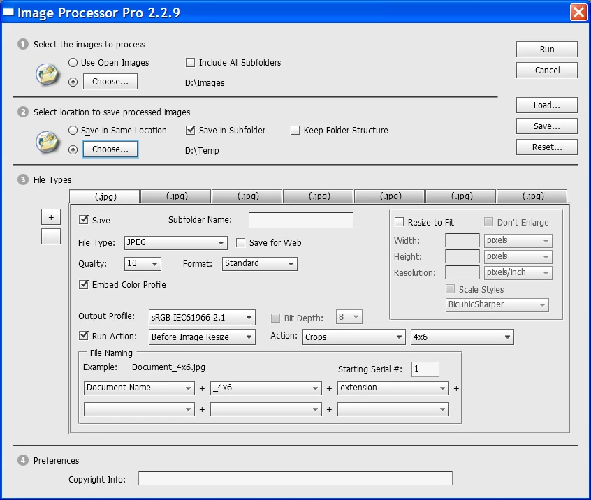

Use menu File>Automate>Image Processor Pro
Choose input folder output folder create 7 jpeg tabs run one crop action per jpeg set file name sufix to the crop size like _4x6
