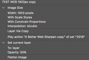

The problem I see there is the your not using Adobe Fit image plug-in you using Image size.   A resize Portrait Image would have a height much larger the 1920 and resize landscapes may have a height larger or smaller than 1080.   All resized image will be 1920 wide.

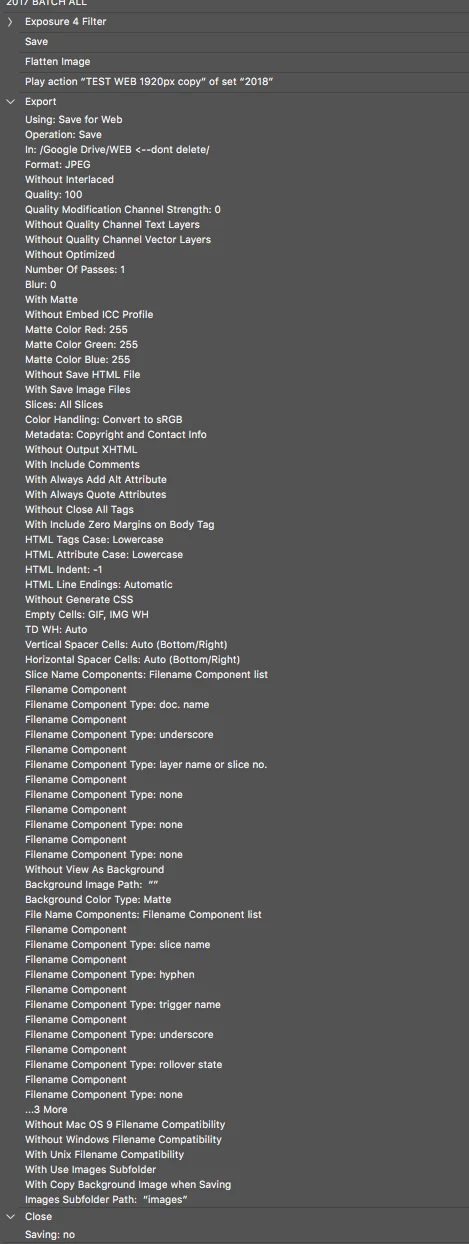

January 12, 2018
Thanks JJ. Here is the action. The problem is somewhere between Test Web 1920px, which just uses Fit Image to resize to 1920px on the long side and then sharpens, and the Export>Save for Web. Here is the action:
