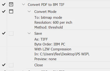

I've created an action which opens PDFs as Grayscale, converts them from  Grayscale to Bitmap and saves them as TIFFs. The action works as intended when used on individual PDFs.

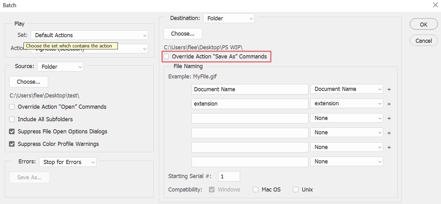

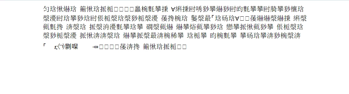

When used as a batch command, it opens the PDFs fine but stops at converting them to Grayscale. (I've tried looking at the log file but it's in Chinese.Why is that--the prefs language is set to Englis) It will open all the files in the designated folder as Grayscale but does not then convert them to Bitmap--it simply leaves them open. If I set the batch to Stop for Errors, it doesn't stop. So that means there's a step missing, but if the action works on its own, how can that be?
I've attached a screen shot of the Batch Settings; it makes no difference if the Save As override is on or off.
First image is a screen shot of the action. The second is of the batch settings. The third is of error log.

Jeff Arola
May 31, 2019
In the Batch dialog check Override Action "Save As" Commands and see if that makes a difference.
fredl11600511
May 31, 2019
Actually, I have tried that--the batch stops whether the override is checked or not.
