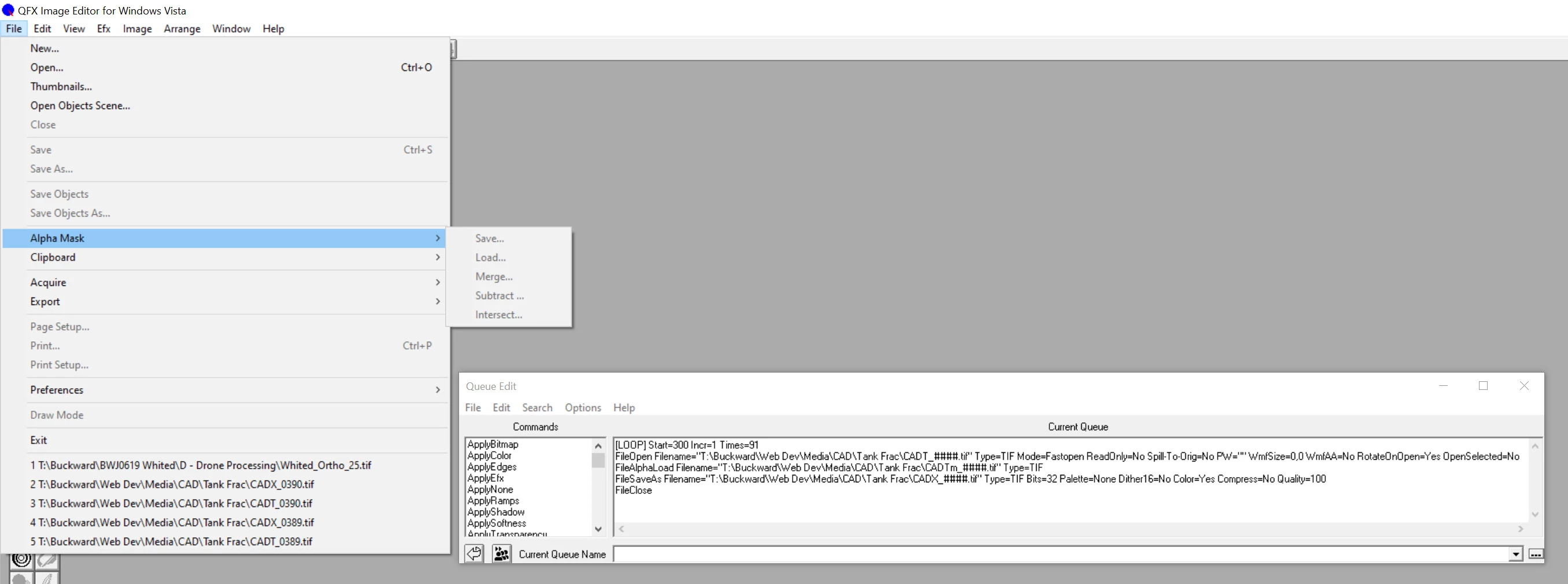

Thanks to this community, I learned how to work on the alpha channel, adding, replacing and performing subtraction calculations between two masks to create a new alpha channel.  Now the hard part (at least I think it will be), batching those operations on an image sequence.  I've found PS batching to be very difficult in the past, compared to the QFX Queue (see included image).
In the queue seen in the image, with these few lines of script, it opens a file, loads an alpha and saves a new file.  If it said FileAlphaSubtract instead of FileAlphaLoad, an 8bit mask image would be boolean subtracted from the existing image.  The #### in the script replaces the numerical image sequence with the Start, Inc, Times values.  Running the script is blazingly fast.  I'm always marveled at how quickly it must be doing these operations AND writting a file to disk.

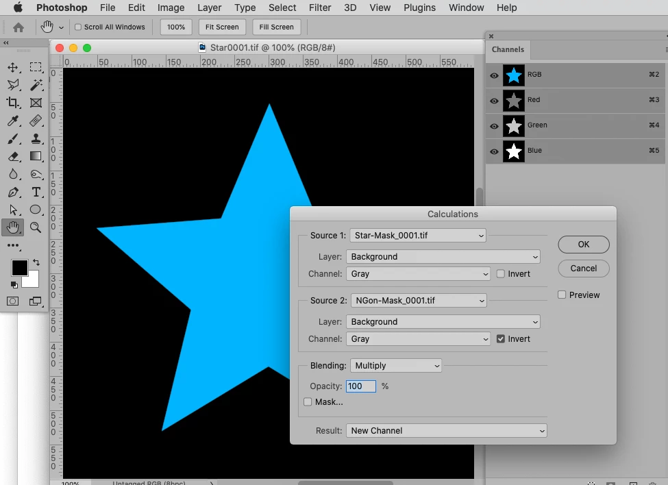

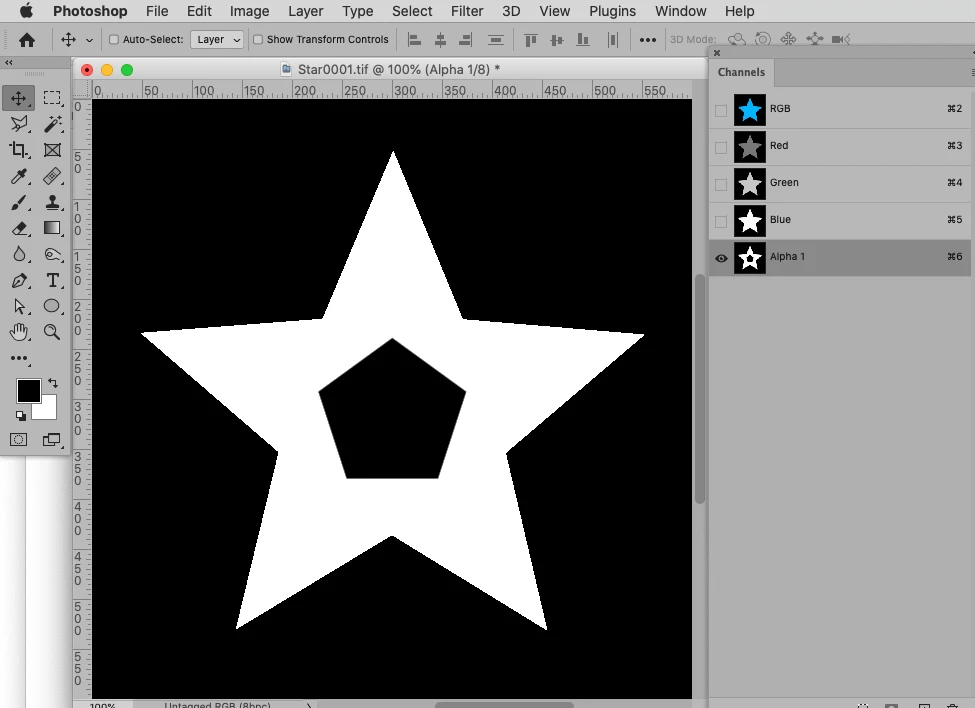

Correct answer c.pfaffenbichler
Star0001.tif is a 24bit tif.  Inserting Star-Mask_0001.tif as Star0001,tif's new Alpha Channel, then saving to say... StarComp0001.tif (32bit) is an example of the first half.
There is another set in the series I included in the zip not shown above.  Star-Alpha_0001.tif is a 32bit star image with the proper mask included.  It is the exact completed version of the fist part above.  Taking that as a start, then replacing it's Alpha 1 channel with NGon-Mask_0001.tif and saving it to say... StarComp0001.tif (32bit) is an example of the second half.
This should work if the Mask-file’s name is the same as the RGB-file’s with »-Mask_« before the numbers.

c.pfaffenbichler
April 10, 2022
Why would you want to waste resources with copying and pasting instead of using Calculations straight-up?
