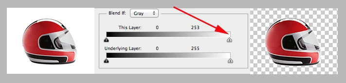

Although the image above is not not a line art image, the "Blend If" option described below still applies.
If there is a lock on the background layer holding the image, drag the lock to the trash.
Place a transparent layer below the image layer
Double click on the image layer to bring up Layer Style
In the Blend If section, gently move the right slider to the left until the uneven white surround disappears.
Layer > Merge Down the image and save as a psd file. (If you save as a jpg, the white will return.)
If you have Adobe Illustrator you will find it will help you get the desired result and deliver vector result, which you may prefer.

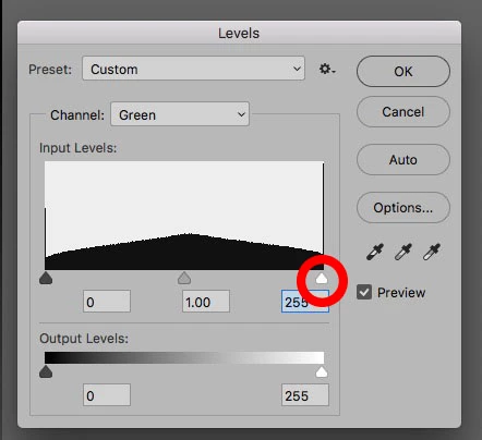

A very simple way to do this is with the Levels command (Menu: Image/Adjustments/Levels). This adjustment allows you to set the Black, White and Mid points of your image. In your case you want to make the undesired not-quite-white values turn white.
Slide the White Level pointer to the left until all of the undesired values have turned white. If you then need to beef up your line work, slide the Black Level pointer to the left.
March 2, 2017
Thanks for responding -
I did try this but to get the background evenly white, the line art pretty much disappears for half of it. So I will probably just have to redo it altogether, and in a new layer.

Try: Image > Adjustments > Levels and adjust the Input Levels to lighten the background.
