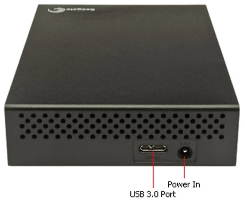

Is there any reason why you don't have your external drives permanently connected?
Do you use those little pocket drives that get their power via the USB lead, or drives with their own power?
This
https://regmedia.co.uk/2008/03/25/wd_elite_passport_1.jpg
vs this
I am now up to eight external drives. Three WD My Books, and five Seagate Expansion.  I have had three WD My book drives fail over the years, and the Seagate drives perform better as well at 180MB/s continuous, as against 120MB/s for the WD drives.  The power blocks were getting a bit OTT, so I now power them via the computer's PSU — it has made things a lot tidier with two less power boards behind the computer desk.

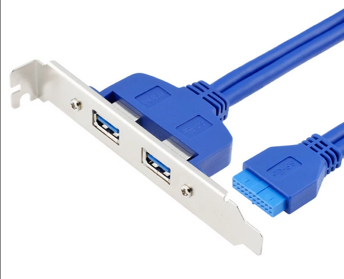

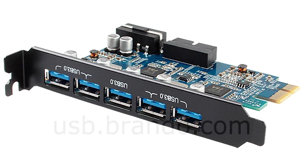

I chose a motherboard with lots of USB3 sockets for my 7900X build (MSI X299 fatal1ty gaming pro i9) but you can get USB3 headers if you have spare PCIe sockets.  You ,might need to check that you have the PCIe lanes available to make the most these.  With so many drives, it can become a real issue.
I also got a header to bring two internal USB3 sockets to the back pane.  This is on top of the two USB3 at the front of the case.  For the sake of a $10 header, it seems crazy not to make the most of all available connectivity.
