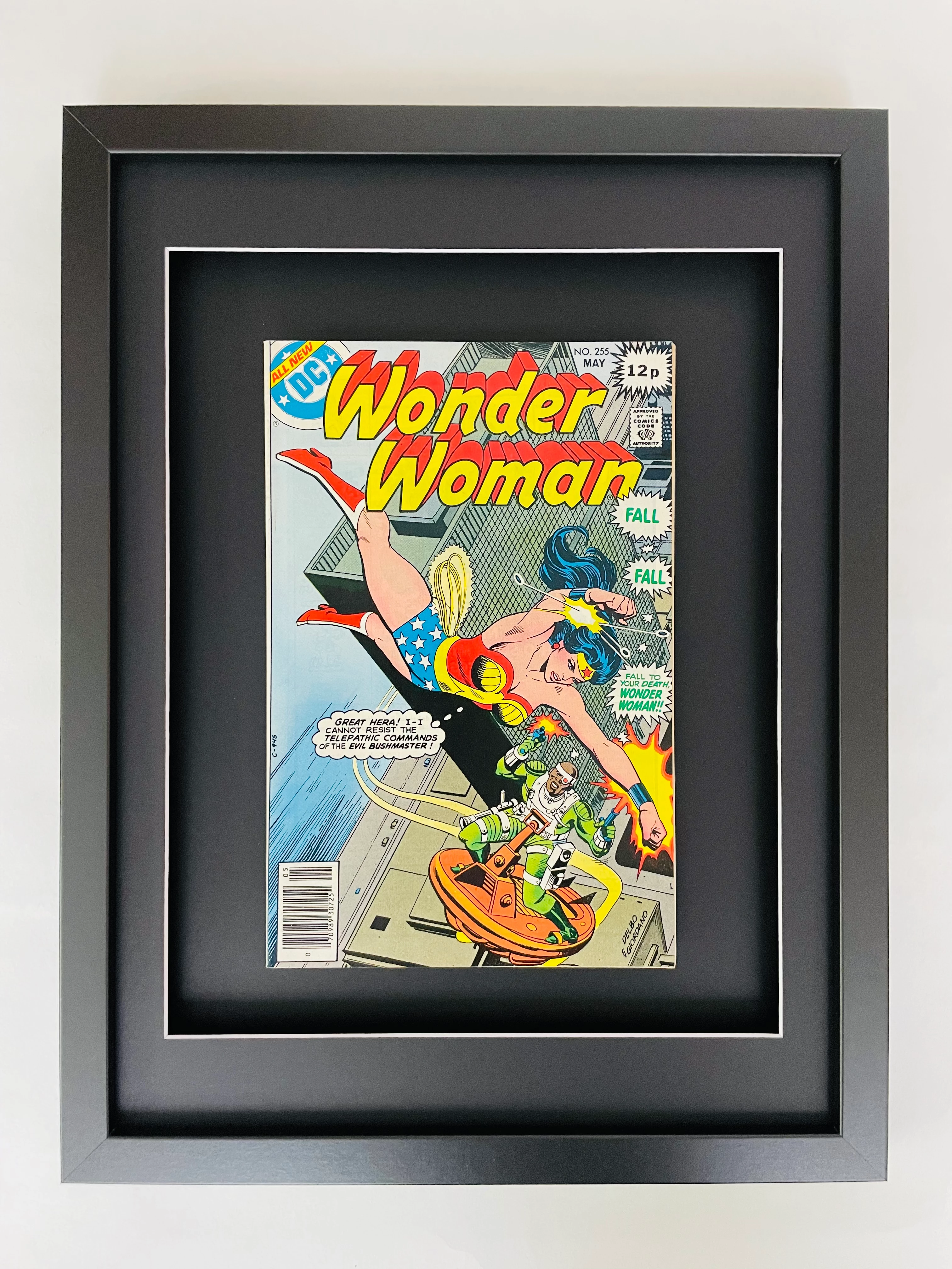

Hi!

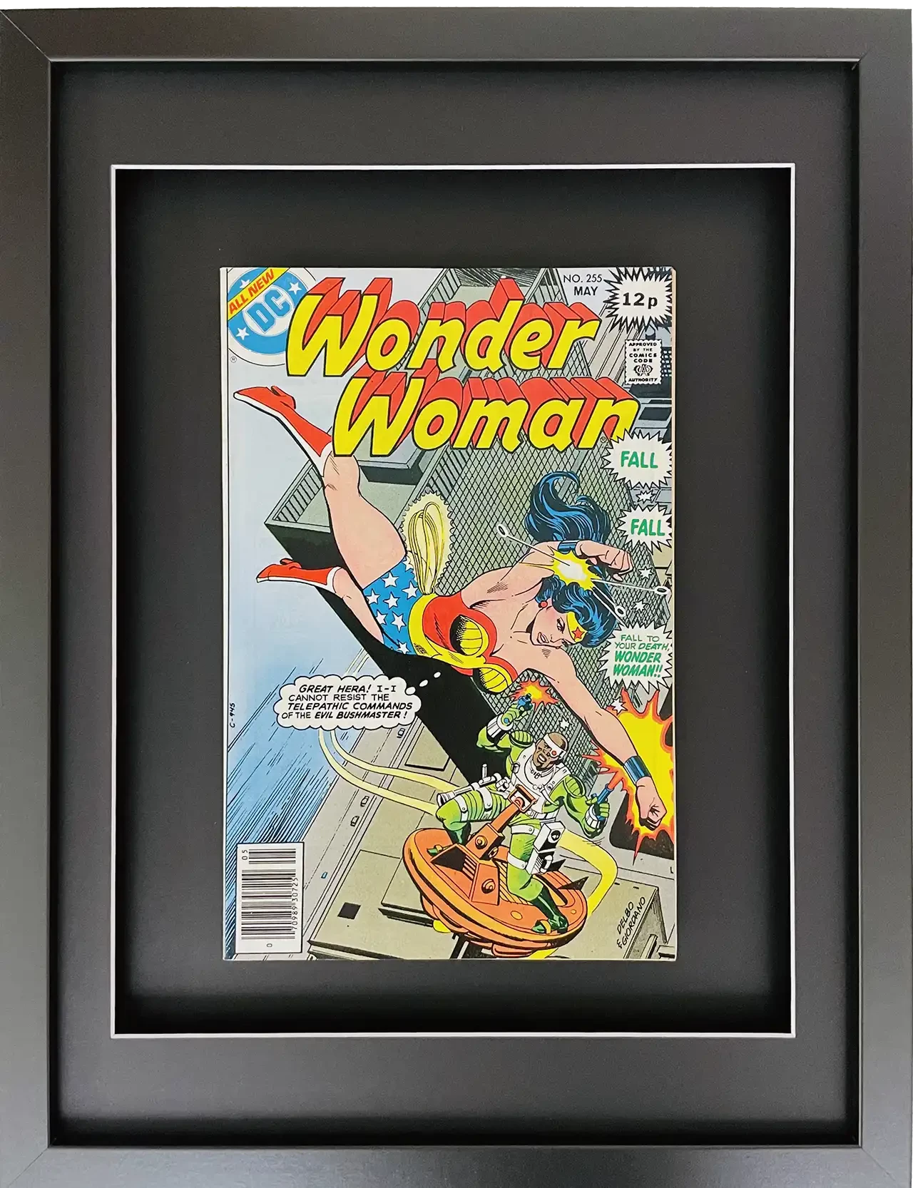

I have an automation that removes the background of a photo of a framed comic, straightens the image and then resizes to a standard size. This generally works ok - see below before and after.
On a few of the photos the selection doesn't always sucessfully select the frame outline depending on the shadows/lighting. I can fix this by tweaking the tolerance and sampling but then it then works on some and not the others. I have tried "subject select" and "removed background" but neither of these works reliably.
Is there a more robust way to select the frame e.g. using the fact it's always a simple 4 sided polygon

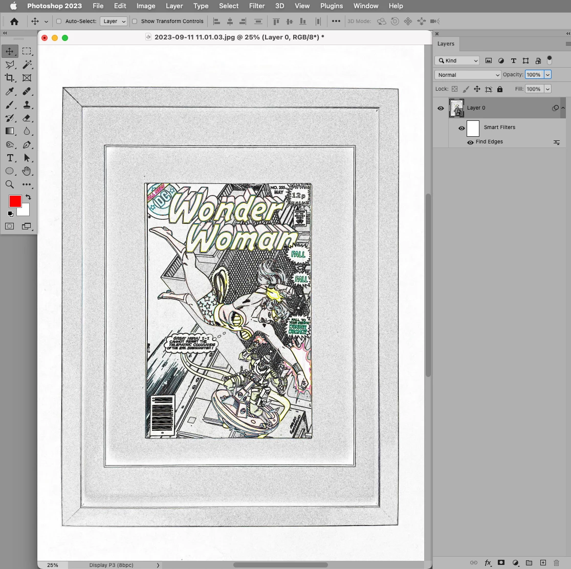

Have you tried involving the Filter »Find Edges«? If the background is always fairly unform this might provide a good basis for differentiating the foreground.
September 12, 2023
Hi! Many thanks and the "Find Edges" tip is great and has got me closer! I can select the non-picture area now a lot cleaner and I'm just working through how to then use this as a mask for the original image - almost there but need more googling!

Personally I often like a Work Path approach, because one can get all the points of the path and process them with a Script.
But identifying a rectangle that way seems difficult because a Work Path based on a Selection of the (pre-processed) image will still likely contain dozens (or hundreds or …) of points, so identifying the »exact« corners would probably need employing some heuristics.
