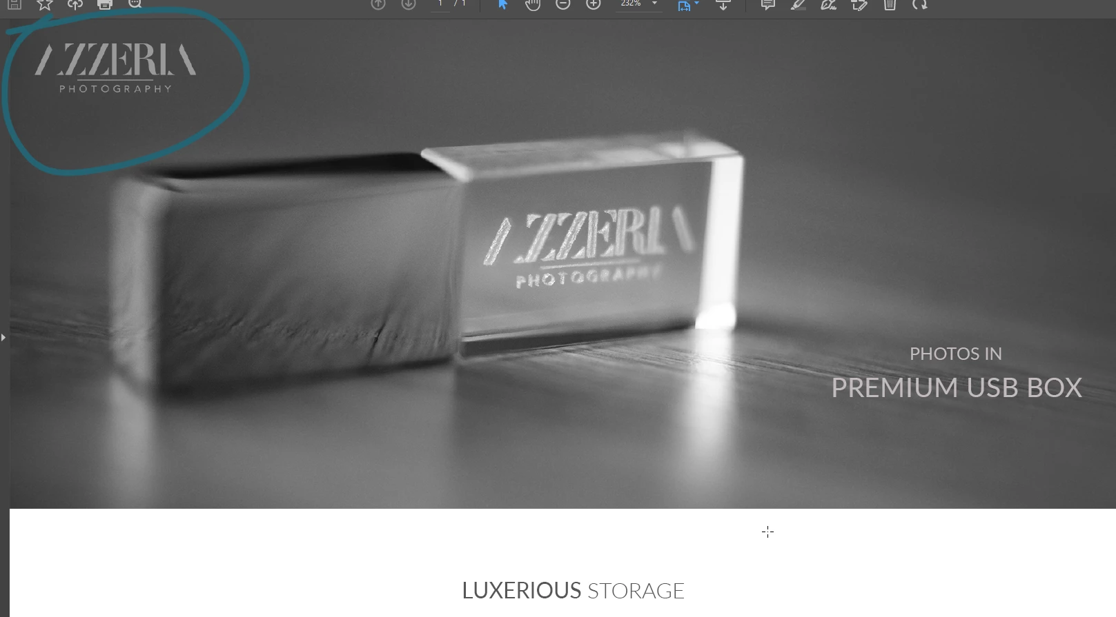

1) The document must contain my logo, which I unfortunately cannot successfully export without it looking pixelated and compressed. I have tried everything I can think of by now.
The original file is an EPS file of 6946 pixels. Exporting this does not look good. So I have tried a number of other solutions, without any success. I attempted the EPS file as both CMYK and RGB - same results. I have exported the logo into PNG, both original size and the exact size needed for the document. I have tried exporting it as PNG for web, exported it to SVG (also as CMYK and RGB).
I believe I am using the correct PDF export settings. All intents are on preserving quality and not downsampling or using compression and remain the highest quality.

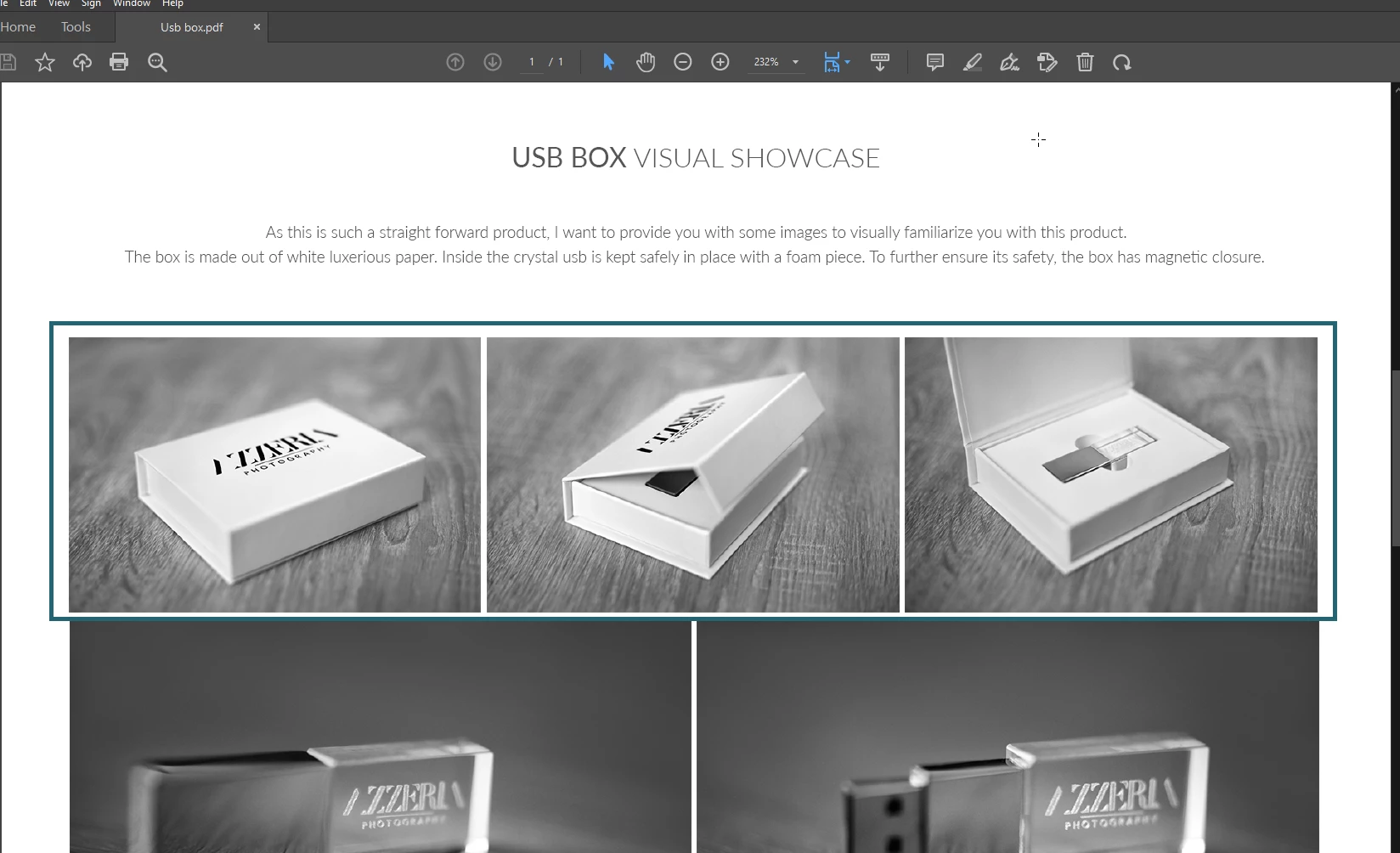

Attached to this thread are 2 files. In both files you can see that the lines are not straight and smooth, which is the common issue both the logo and images experience in the result of exporting my PDF's.
Moving on to the second issue
2) In exporting my documents my images again does not look well. I have the idea that my images experience the same issue as the logo in export, but I really am lost as to what I can do to fix this. The photos as well as the logo are of high quality. This is not a problem of the source files not being of good enough quality, which results in less desired quality in export.
My documents are created for my photography website, and they contain a lot of images so it is very important for me to find a solution to this.
Thank you kindly in advance, for anyone taking the time to read this and or possibly try to help.

Also, your logo has angles that lower res just loves (not) so you will need to export at a good resolution to minimise the staircase effect, but you already know the real answer here. To combine vector and raster PS is not the proper tool.

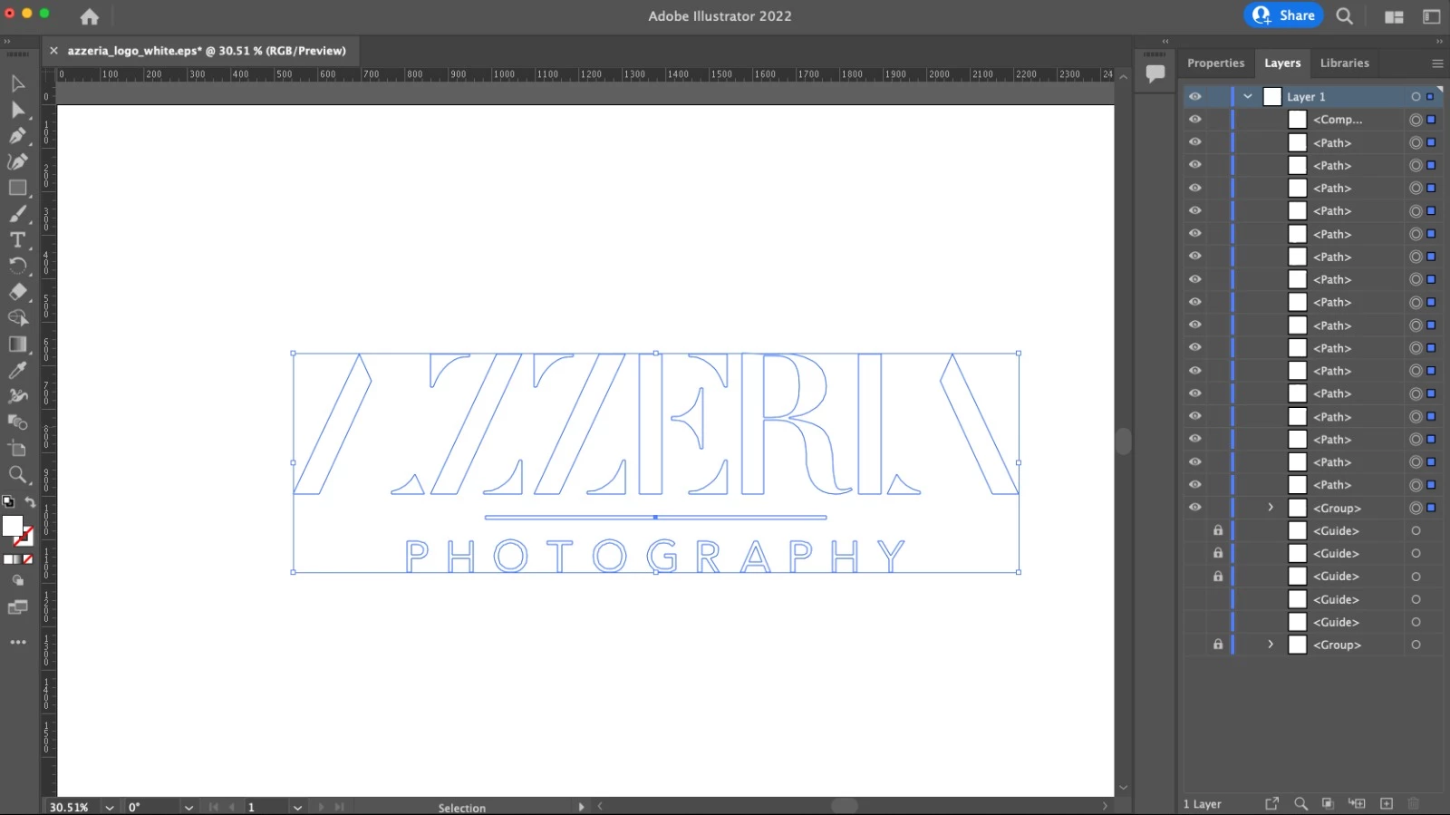

How did you place the logo-eps? As a Smart Object, pixel layer, …?
Does the eps truly contain vector data?

EPS file
Honestly I am not sure. Someone I know opened the file in Illustrator to check. I believe it is, but see screenshot for further details

It is worth mentioning that it is not only the look of the logo in the images I am trying to resolve. The edges of the white box in question is also not displayed straight but also has (what I believe you refer to when you say) staircase effect.

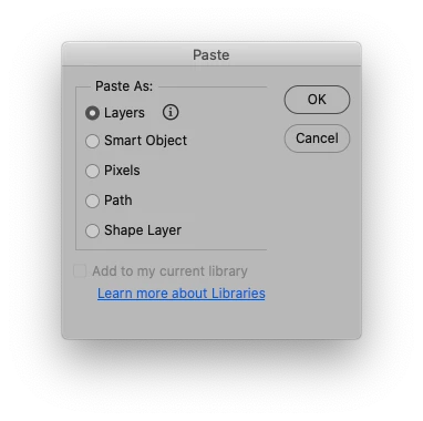

The logo seems simple enough to work as Shape Layers in Photoshop, so try copsing it in Illustrator and pasting it as »Layers«, that way Paths can be output as Vector content in a pdf.
