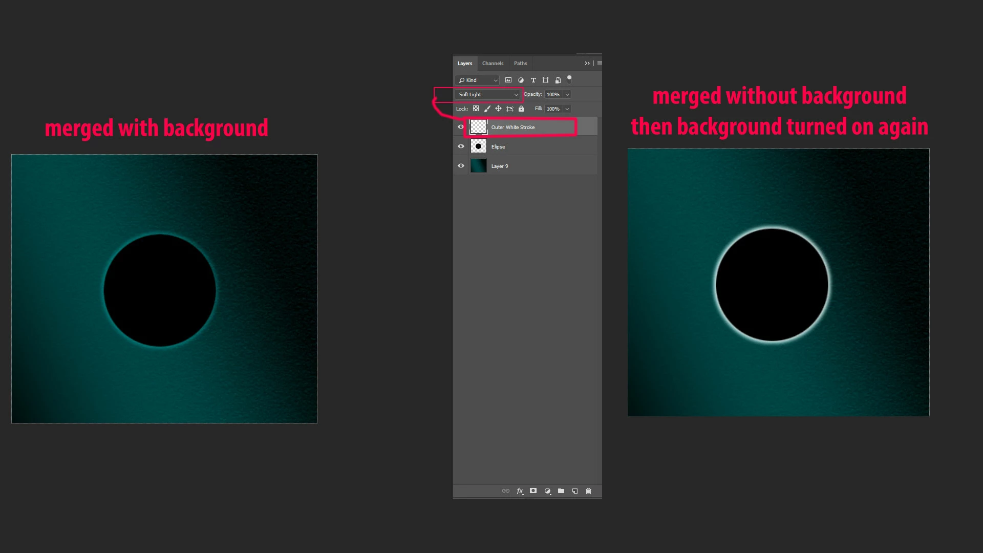

    Hi thanks or you replies.
    Here is a screen shot, with one of the layer blend modes set to: soft light.
    If the 3 layers are merged, the blend mode is intact. When I remove the background layer, and try to merge, the blend soft light blend modes, seems to default to normal again making the white stroke visible. Now I'm posting this more for theory reasons. I know I can make a soft brush and make a stroke, lower its opacity. But this is more for educational reasons I'm trying to understand why PS is behaving this way.
    c.pfaffenbichler
    July 29, 2019
    That is as expected, one Layer can only have one Blend Mode.
    For some Blend Modes and Layers the effect can be »isolated« (in RGB for example a Layer with true grey pixels set to »Multiply« can be transformed into a Layer with black pixels with transparency) but not for all.

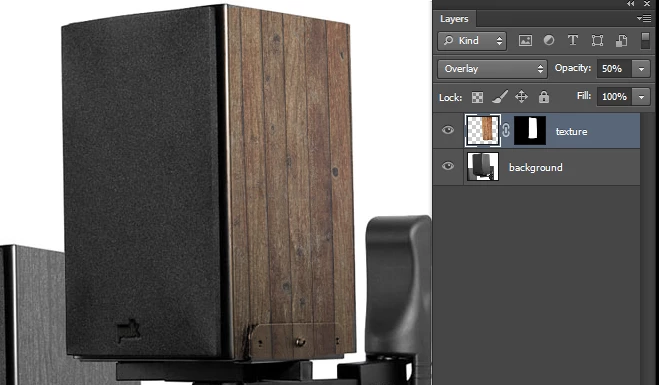

    Something like this? Is it possible to save just the texture layer in PNG, without the background?
    davescm
    August 18, 2022
    Copy the mask onto the background before saving as PNG
    Dave
