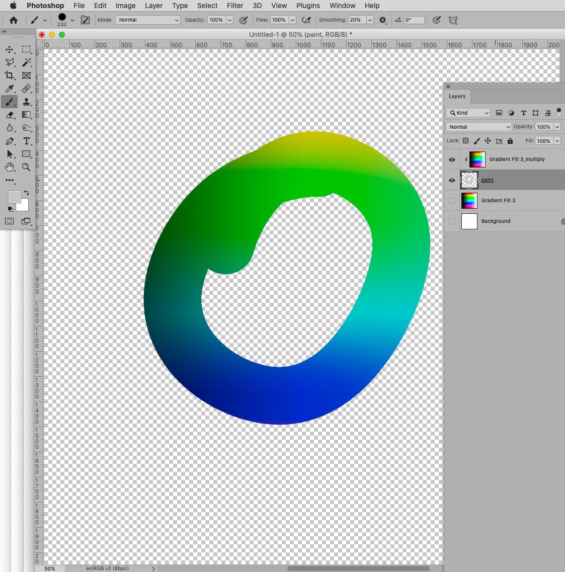

c.pfaffenbichler
April 25, 2022
Could you please post screenshots with the pertinent Panels (Toolbar, Layers, Options Bar, …) visible?
Are you actually painting on the Layer with the existing content or on a separate, empty Layer?
In the latter case the Brush’s Blend Mode would naturally only take effect in relation to pixel content on the same Layer, like previous strokes.

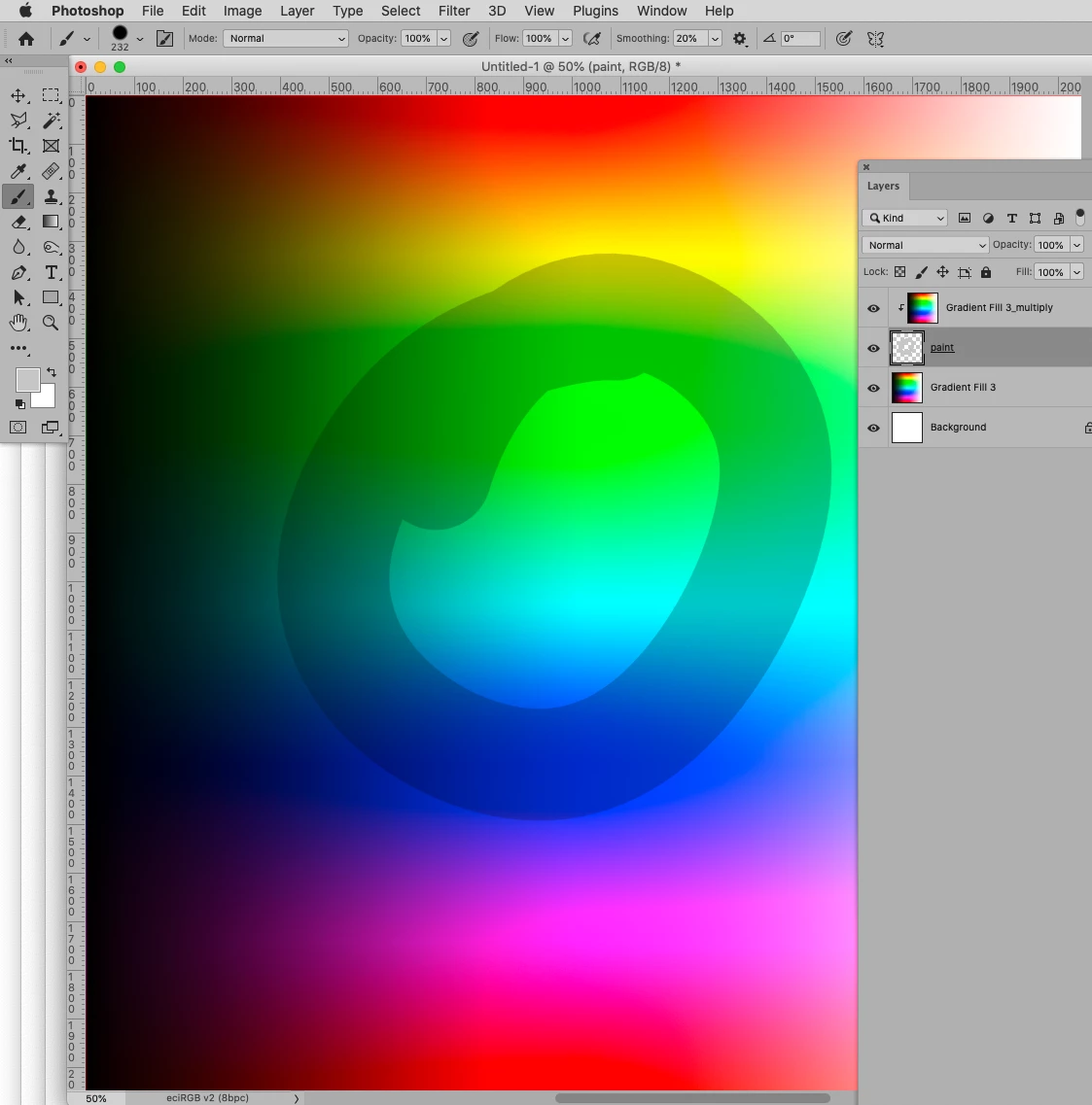

c.pfaffenbichler
c.pfaffenbichlerCommunity ExpertCorrect answer
April 25, 2022
I think what you are driving at is not how it works.
You can lift content from other Layers with the Clone Stamp Tool for example, but the Brush Tool just paints – its Blend Mode determines how it interacts with Layers on the same Layer, but that’s about it.
Depending on what you want to achieve you might be able to »reverse« the setup, though.
So you could have
– duplicate of the lowermost layer set to some Blend Mode Other than Normal and Dissolve, clipping masked to the paint layer
– layer to paint on
– lowermost layer
and, if necessary, merge the Clipping Group later on.
