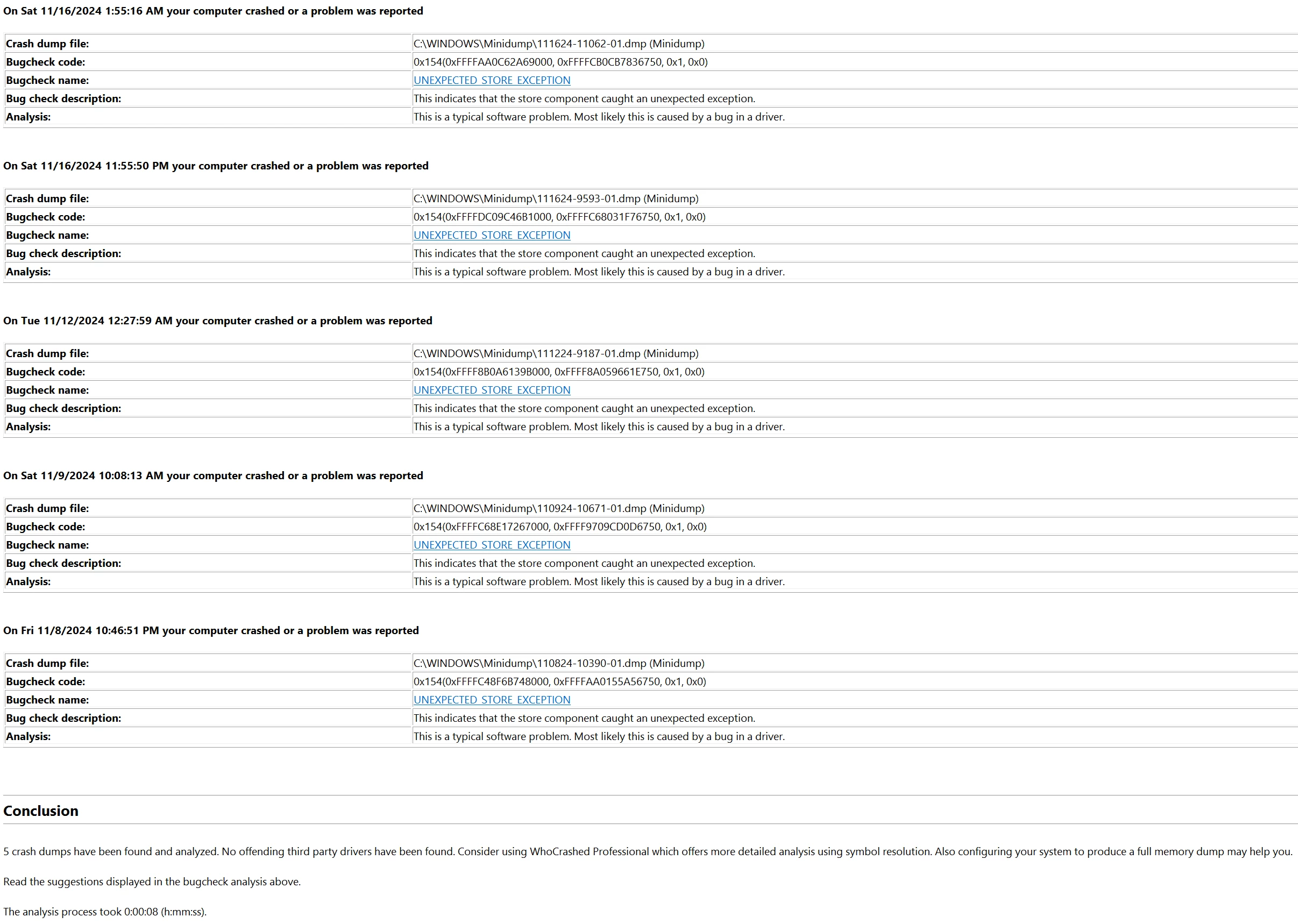

Correct answer AlanGilbertson
This indicates a disk ("STORE" as in "storage") problem. There's a good write-up on what this is and what to do about it here: https://malwaretips.com/blogs/unexpected_store_exception-what-it-is-how-to-fix-it/

After I used WhoCrashed these were the results
