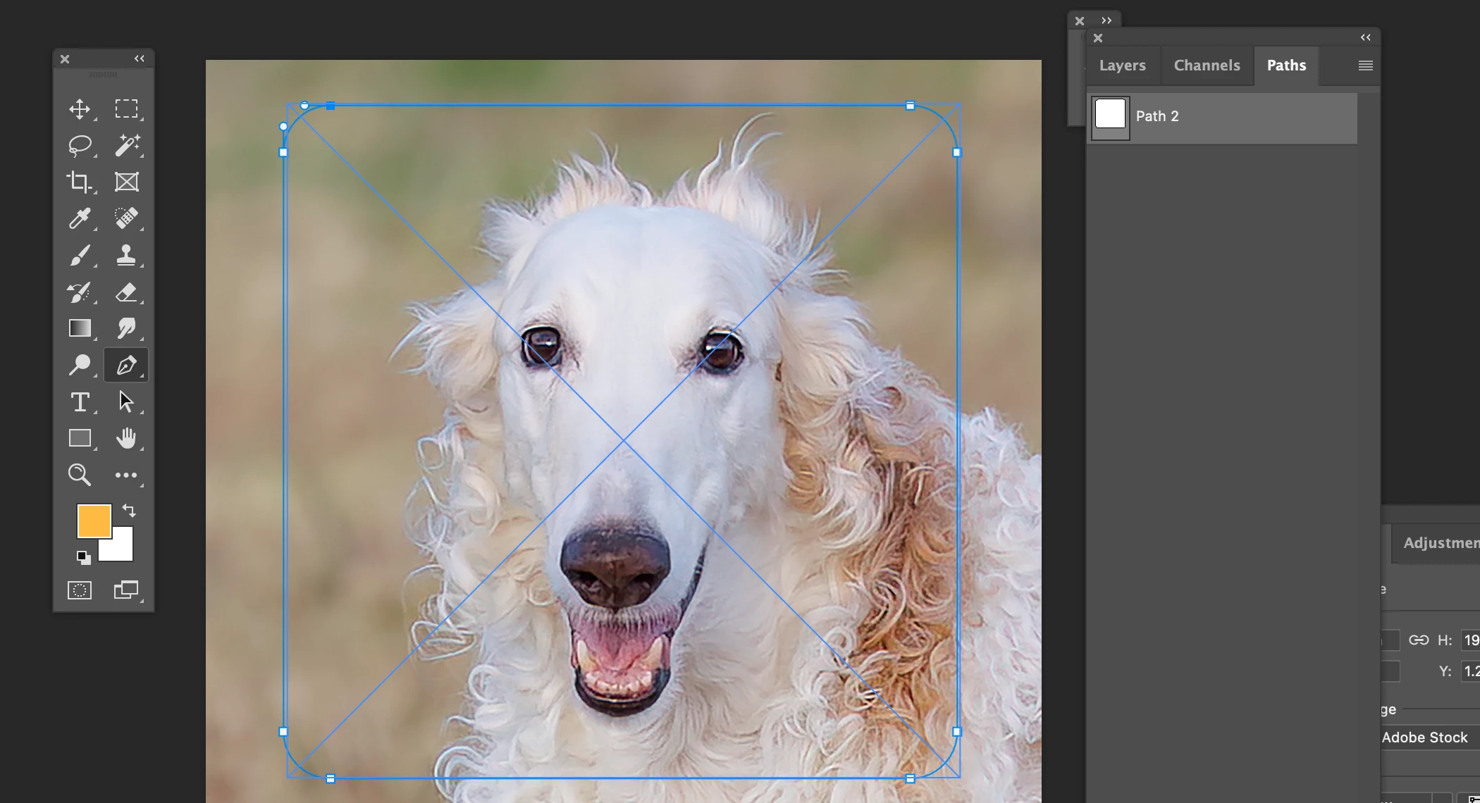

Ken Nielsen
January 15, 2023
I am confused and need help. The path I made has a square but the rounded-corner shape on the same path seems to not have attachment to the original path, which is all one path. I see that I need to set the rounded corner dimension and THEN draw that path so the Rounded Corners are not something that can be changed dynamically. This whole area I can see is quite valuable, but learning it... I am not quite catching on. Where do I go from here to gain control over making paths like this?

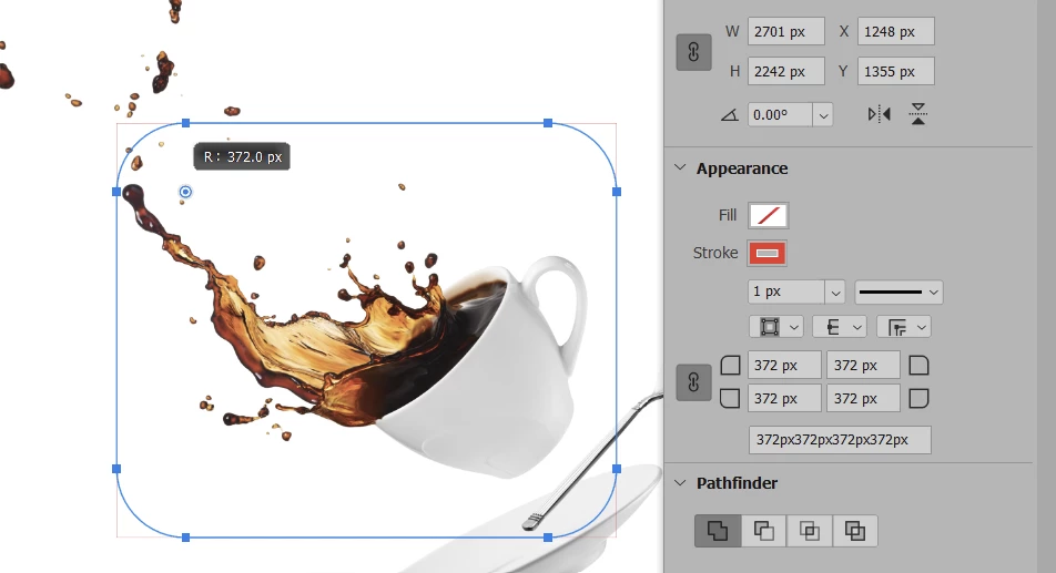

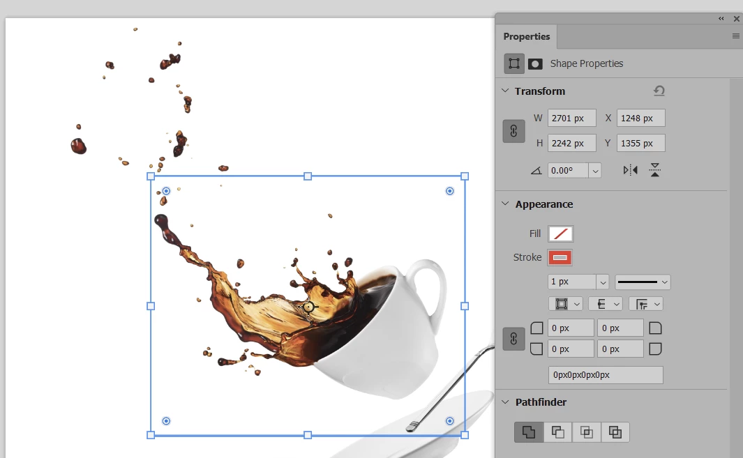

Conrad_C
January 16, 2023
See how in my example there is an x through the 'Frame' but contrary to what you have said about Paths being the only choice where I can have rounded corners, you can see the little 'dots' in the center of the radius of each of the four corners and moving that dot will change the radius of the corner... the Properties panel says it is a 'Frame' or at least the Frame box is checked in the upper portion of the panel. Please excuse me as I flounder with this concept now. I want to learn.

jane-e
January 15, 2023
Hi @Ken Nielsen
You drew a Frame and frames don't have rounded corners. Delete it.
Look at the screenshot from Pixxel where he has marked the correct tool for drawing rectangles and use that tool instead. The Properties panel will say "Rectangle" instead of "Frame" at the top.
