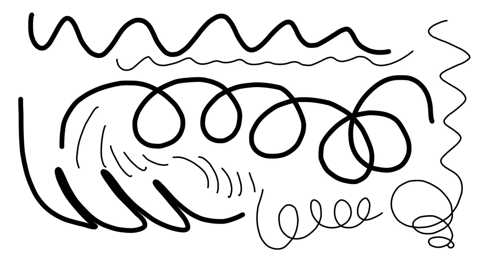

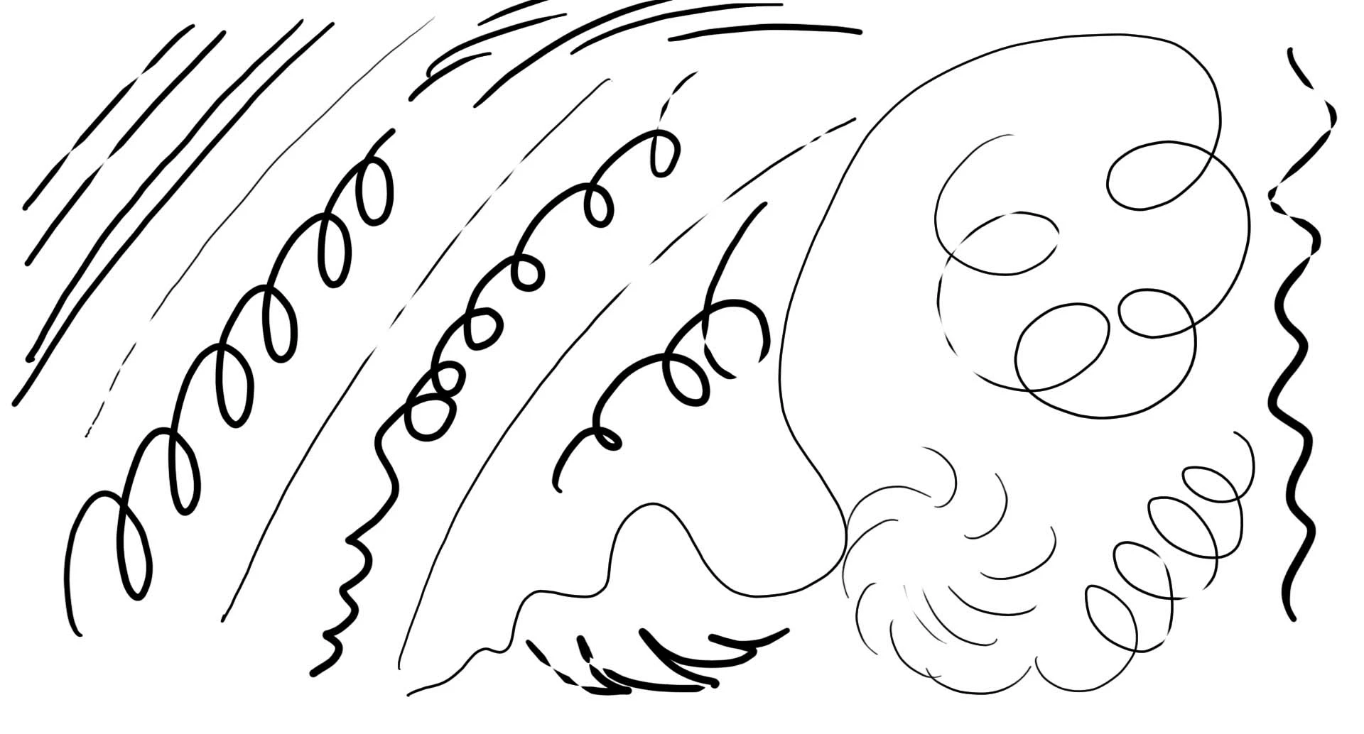

I've had an Intuos pro / 5 for years and I've not had any problems like this previously. Today I got a new Cintiq 16 and I'm having some challenges. I've reinstalled the driver, made sure to do so cleanly as much as possible but it's still an issue. But it's only an issue in PS Cs2. It doesn't happen in CS 7, Sai, or Krita . So I don't think it's specifically the pen or the tablet itself.
I've tried it with windows ink on and off and that doesn't seem to make a difference.
Any ideas on what I can do?

I just got me a Cintiq 16 in 2022 and had the same issue with PS CS2.  I found a fix for anyone from here on forward.
When opening a new document select "16 bit" in color mode.  That's it.

I'm using PS CS2, this problem occurs with brushes only if shape dynamics are on (the lines in the first image).
