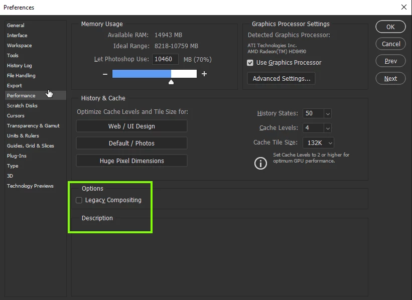

Hi
Try going into the preference and disabling legacy compositing if it's enabled and restart Photoshop to see if it helps

Hi

Thanks Ged Traynor. This really helped solve the issue. Thank you so much. :))
However, why does this happen with the 'Legacy Compositing' selected? I'd like to know. I laways thought selecting that option is supposed to help the rendering process.
