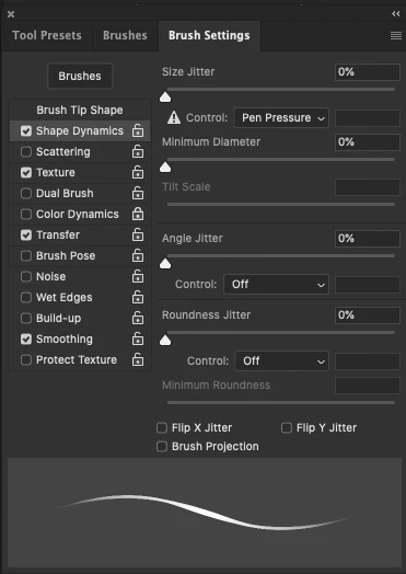

I am experiencing trouble with the brushes in photoshop.  I can't seem to reproduce what causes this but it is causing my work flow to suffer.  Hoping someone else has experienced this so Ii can get some help.
Every couple of minutes the pen pressure in the brush settings box has a triangle with an '!' next to it.  When that happens pen pressure is gone.  I've tried turning the setting on and off; switching to a different app; deleting and resetting the wacom preferences; switching brushes; etc.  Eventually it flips back to pressure sensitive again and I enjoy the freedom for a few minutes before something sets it off again.
I can't tell what causes this.  Sometimes it happens after walking away for a minute.  Sometimes it happens after using my ExpressKey gadget.  Sometimes it just happens while I'm making an adjustment.  The only thing I have observed is that, prior to the recent update on 4//13/2020 I was experiencing and issue with the BUILDUP setting turning on at strange times.  Now the BUILDUP setting seems to be fixed but this new issue is rearing it's head.
Any helps would be appreciated.

April 22, 2020
It's a known issue with the 21.1.2 update.  Check my post history for the multiple threads myself and others have created about it.  Supposedly they're working it.

David Miles
April 22, 2020
Hello?  Is this thing on?
Ha!
Maybe my issue is not a very common one.  I have sorted out a fix that seems to work for now.  When I notice my brush is stuck without pressure sensitivity I lift my pen far enough away from the sceen that it breaks the connection.  Then when I replace the pen I can see the cursor snap back into shape indicating that pressure sensitivity has been restored.  Is this a memory issue?  Software related?  Wacom related?  If someone has an idea please comment otherwise I'll just mark my thread as solved... albiet a sloppy solution at best.
David Miles
April 21, 2020
Also, on a whim, after reading another post... I went to Library/Preferences/Adobe Photoshop CC 2020 Settings and I renamed it to Adobe Photoshop CC 2020-old just to see if a new set of prefs might help... it didnt.  I opened photohop, loaded one one of Kyle's amazing brush sets and tried it out.. each brush was a stroke without pressure variation.  Then it switched back briefly... then it switched again.  ug.
