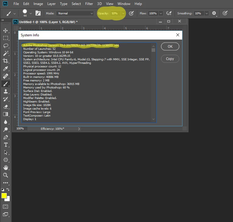

    October 27, 2017
    CC 2018 is the latest version and on my Windows systems there is an opacity setting. However some brush tools do not.  Color replacement brush, mixer brush etc. What is in the tool option bar depends on the current tool....
