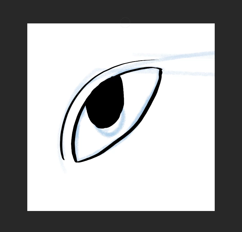

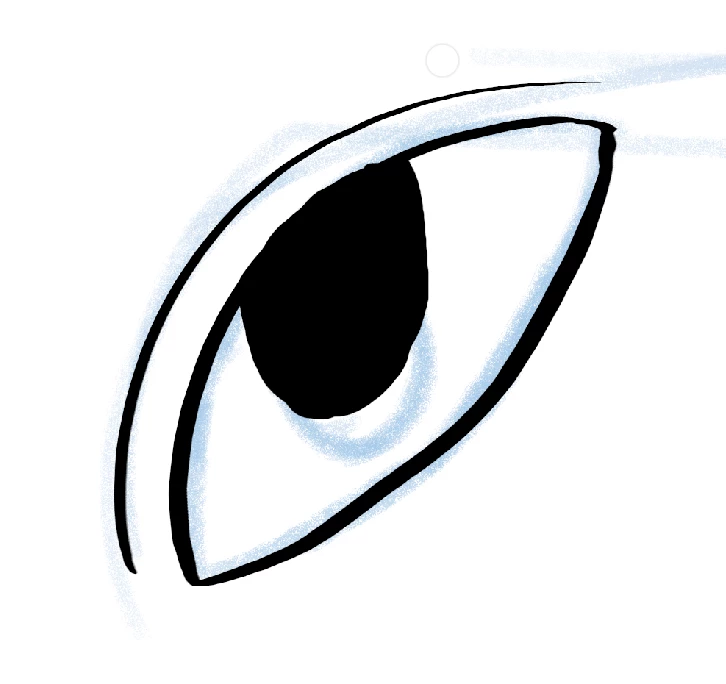

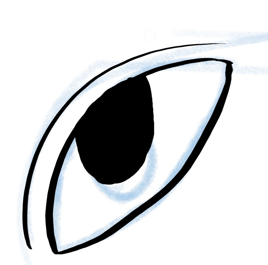

Below is an Image of An eye I drew, I've been having a problem when it comes to my drawings being pixelized, but for some reason at certain zooms it's not if I fit to screen the image it has pixeilization (Image 2 is a fit to screen image of the drawing) Yet if I zoom in once its perfectly smooth but only at that zoom. again If I zoom out once from the fit to screen its perfectly smooth again (Image 3) I can't figure out what I am doing wrong, so many Youtubers I watch use Photoshop for drawing but I can't seem to understand how their art is so perfectly smooth and mine isn't,
My canvas Size is 5000 Pixels by 5000 Pixels  and Resolution is at 300 sometimes 400

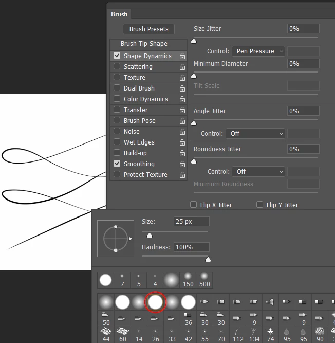

We need to see the brush preset to understand what might be going on.  Unless it is a hard round brush with no scatter or random size dynamics, then how are we going to understand the resulting brush strokes?
You could maybe have a look at cache levels in Preferences > Performance, but I don't think the sort of pixelated effect having cache levels set to 1, is what is happening here.

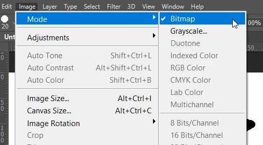

The other thing is, to make sure you are using the brush and not the pencil, or that the Image Mode is not set to bitmap
