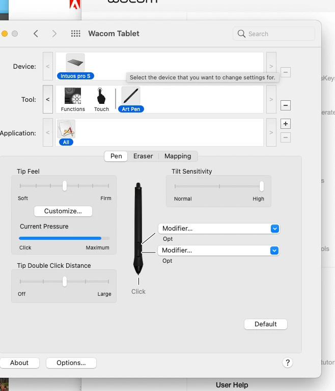

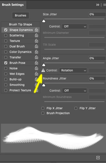

Mac 11.1.PSCC 22.2. Created a brush years ago that would rotate when turning Wacom pen. Now it won't rotate Help! Rotation option has an "!".

Are you using the Wacom "Art Pen" as opposed to a standard pen? That is needed to control rotation
Dave
kiskamAuthor
February 28, 2021
Yes, the art pen. Also have tried the grip pen AHA! Had both pens showing. Removed the grip pen. Rotate working now. Thanks!

c.pfaffenbichler
February 28, 2021
That alert-signal means that it does not work.
Does pressure work as expected?
