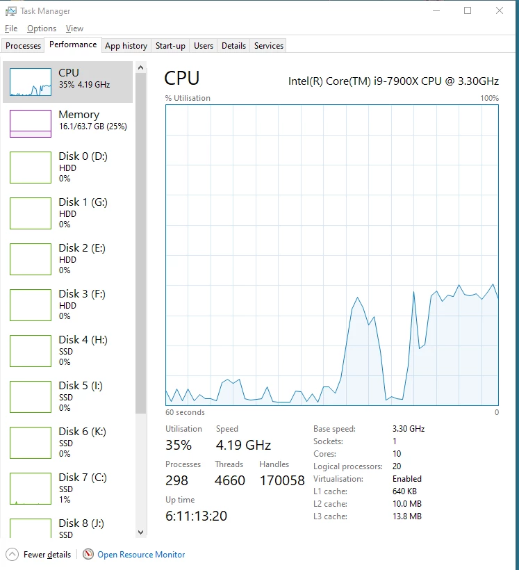

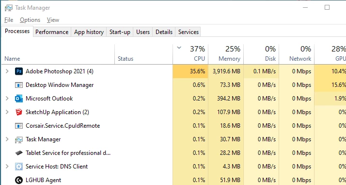

If you are using Windows 10, open the Task Manager > Performance tab and try painting with a large brush (1000 pixels 1% spacing) See what is going on regards CPU usage.  I went crazy for a good few seconds to get this for instance
Try the same thing in the Proces tab but click on the CPU column to order things by cpu usage.
BTW The info you provided is not as usful as CPU clock speed.  Photoshop does make massif use of the GPU unfortunately.  A very fast processor is much more important.
[EDIT] I should have mentioned that unless you are using an underpowered system, my money is on the tablet driver,  What is your CPU, and what is its clock speed?

 I did the test you suggested above.  The numbers I'm getting are Process 38.5% Performance 41%.  What is this telling me?
