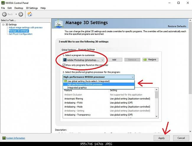

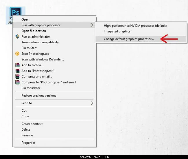

    Easy peasy, this worked for me hopefully it will work for you. I forgot how i found this but here it is.
    1. Right click on the Photoshop shortcut and click on "Run with graphics processor" and then "Change default graphics processor..."
    2. When NVIDIA Control Panel opens Adobe Photoshop should already be selected in the program settings. Where it says "2. Select the preferred graphics processor for this program:" Change it to High-performance NVIDIA processor and click Apply down the bottom.
    January 10, 2016
    Thanks for that.
    Dual GPU machines (like my gaming laptop) default to the Intel HD Graphics, crashing Photoshop on start. Changing the settings in NVIDIA Control Panel fixed it!
