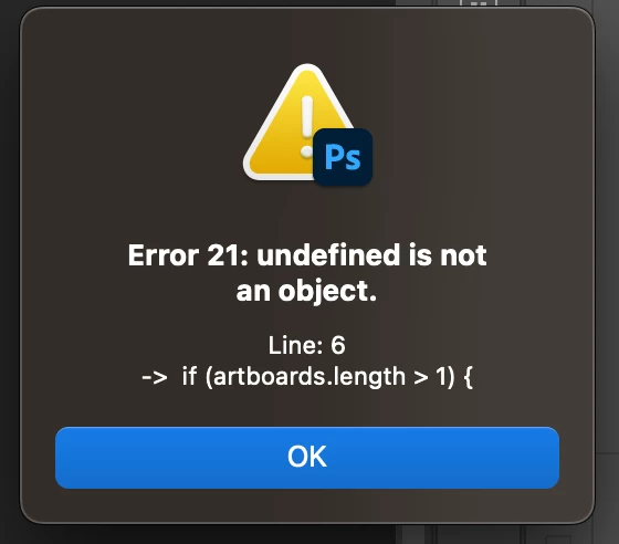

Error 21: undefined is not an object.
Line: 6
->  if (artboards.length > 1) {
And the error is this:
What I am doing wrong?

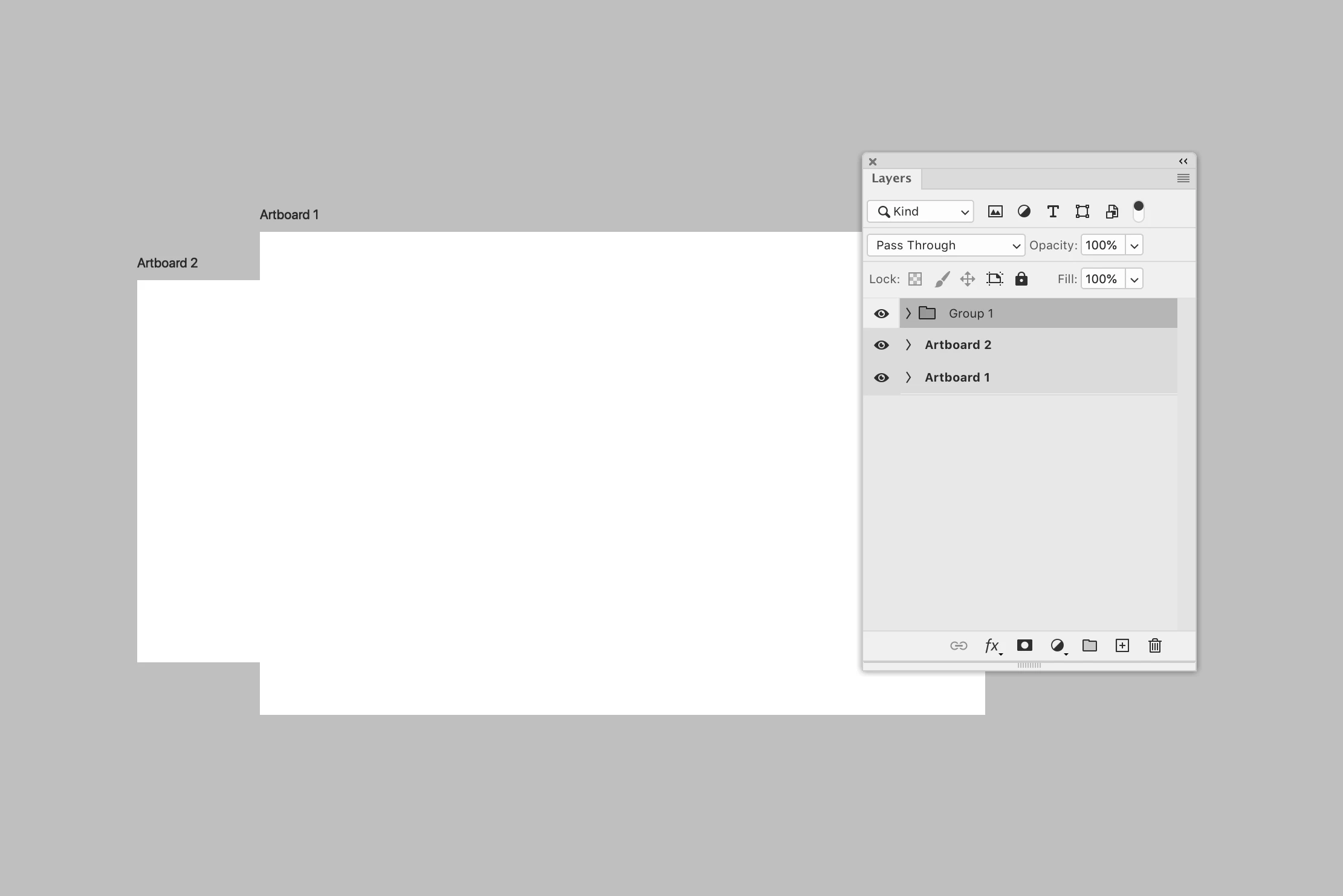

Also, it looks like you are referencing the Illustrator API, which isn’t going to work with Photoshop
https://www.indesignjs.de/extendscriptAPI/illustrator-latest/#Artboard.html#d1e63472
In Photoshop you can get a layer’s .typename, and Artboard layers (as well as layer groups) return as "LayerSet":
var d = app.activeDocument.layers;
var al = []
for (var i = 0; i < d.length; i++){
    if (d[i].typename == "LayerSet") {
        al.push(d[i])
$.writeln(al)
//returns [LayerSet Group 1],[LayerSet Artboard 2],[LayerSet Artboard 1]

Hi @mariang89846507 , looks like you are trying to run the script from Photoshop—Photoshop documents don’t have an .artboards property. I think you would have to create an action descriptor in order to get at Photoshop art boards:

You’ll probably get an answer in the Photoshop forum, but your artboards variable returns as undefined in Photoshop—you’ll need to reference the Photoshop API, not Illustrator’s.
var docRef = app.activeDocument;
var artboards = docRef.artboards;
$.writeln(artboards)
//returns undefined
