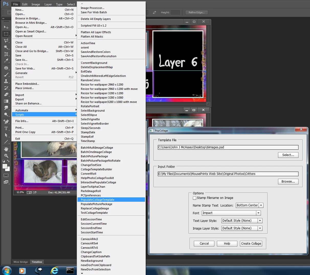

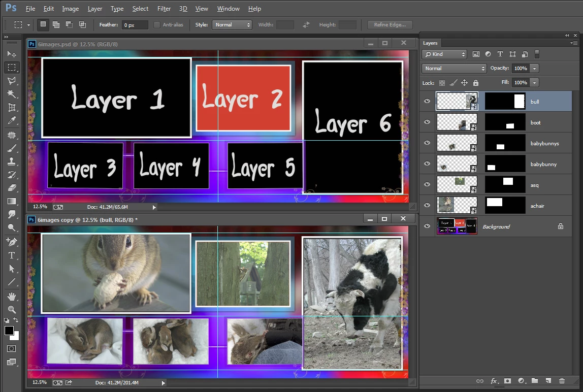

I created a template for you latest example using its size 30" x 12" at 200DPI and the 6 different aspect ratio images. There is still some tilt in image 3 and 5.  You can download the template http://www.mouseprints.net/old/dpr/6images.psd
I only used a Background layer.  I did not add and upper overlay layer however the alpha channel I created for image 6 will let some of the background show through image 6.  Here is a screen capture with the Template in Photoshop and under it a populated version. Also just copy my scripts into Photoshop folder Presets\scripts and use them from Photoshop  menu File>Scripts>My Script Selected. The extendedscript toolkit has problems with some things.
