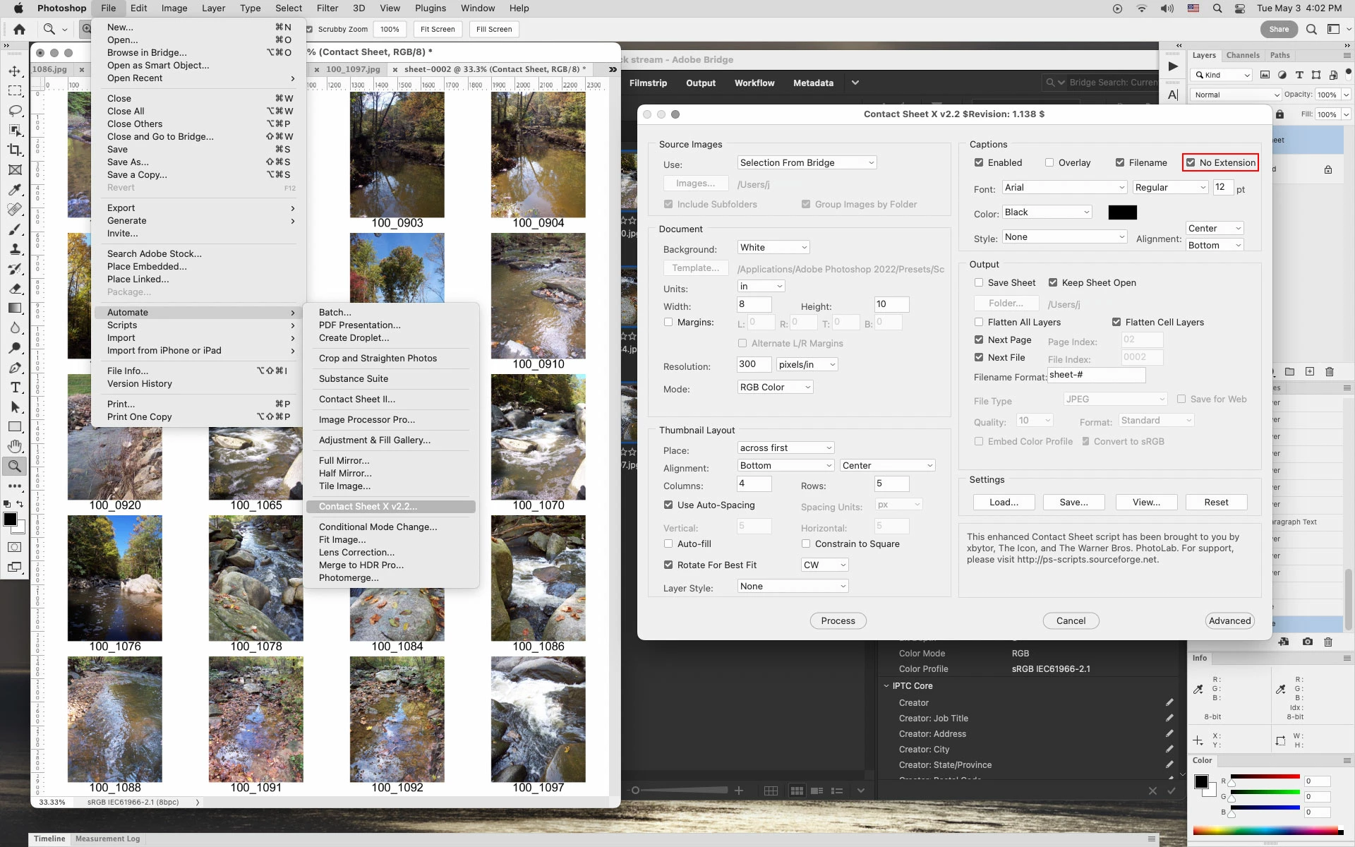

You should be able to install the CSX-2_2 contact sheet manually by using the files in the CSX-2_2.zip
or using Anastasiy’s Extension Manager to install using the CSX-2_2.zxp.
https://install.anastasiy.com/

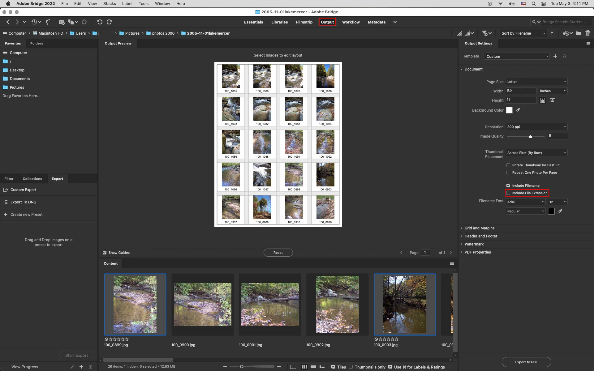

Also, Bridge has a Contact Sheet under Window>Workspace>Output

Jeff Arola
May 3, 2022
warm_3Author
May 6, 2022
Yes, as above.
Thanks to all.
Working excellently now.
Tony

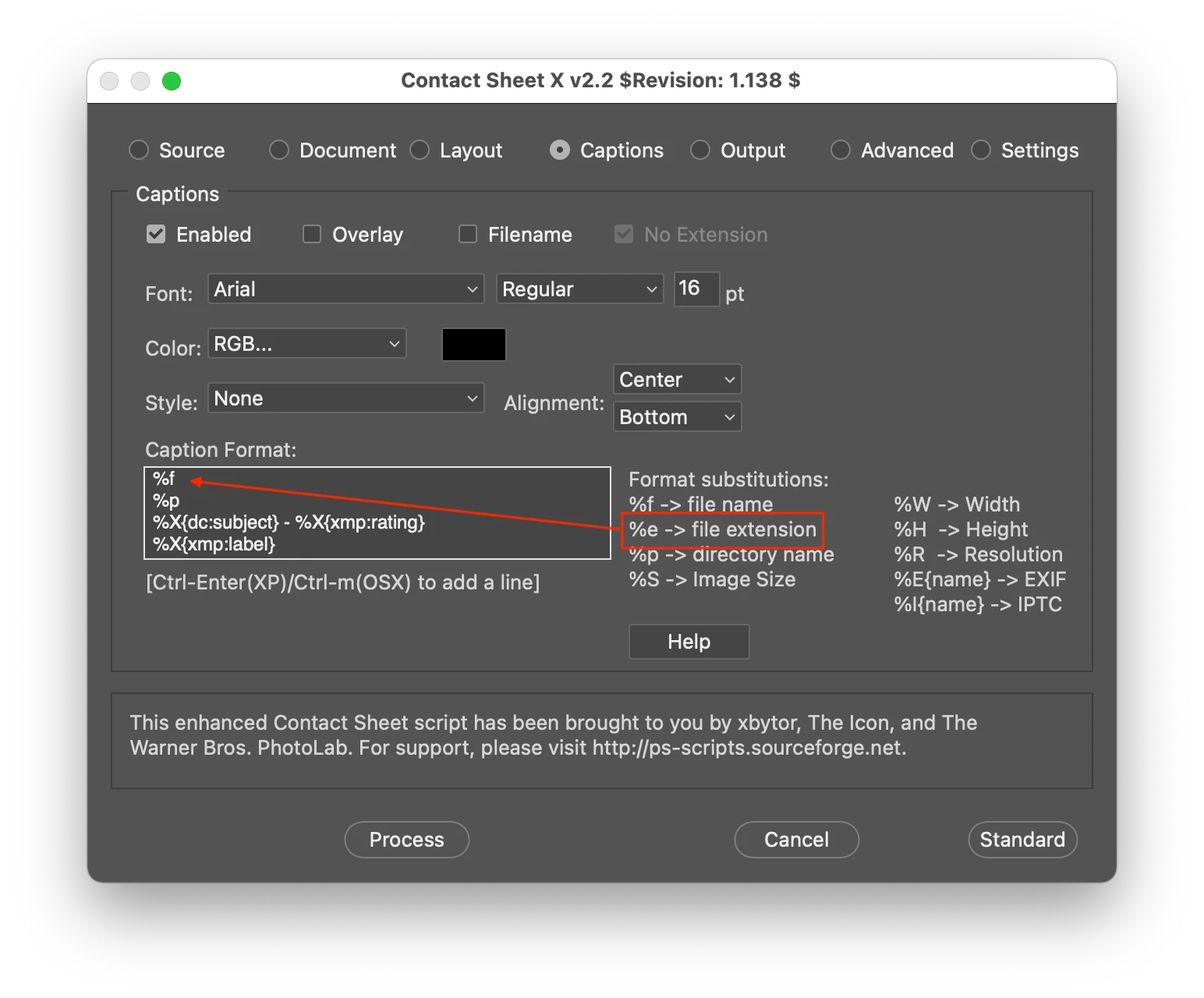

I'm posting from my phone so I'm not sure of the features... But another option is ContactSheetX from xbytor:
https://sourceforge.net/projects/ps-scripts/files/ContactSheetX/v2.2/
Edit: I am now in front of a computer, here it is in a different format than shown by Jeff:
warm_3Author
May 3, 2022
I have downloaded but it tells me that it needs to be upgraded for MAC 12.3.1
The scripting stuff looks scarey…
I filled in the form asking for an upgrade
Thanks
