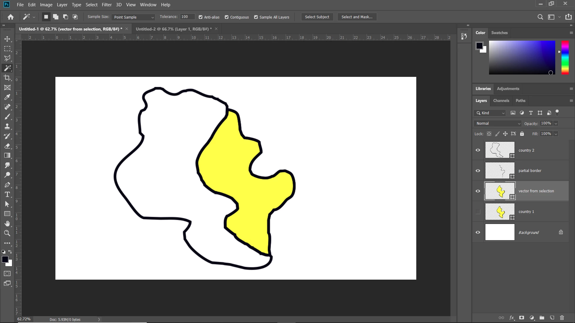

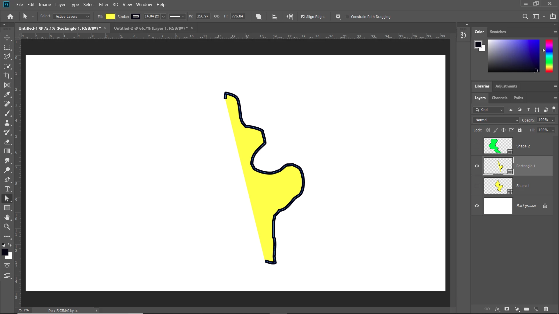

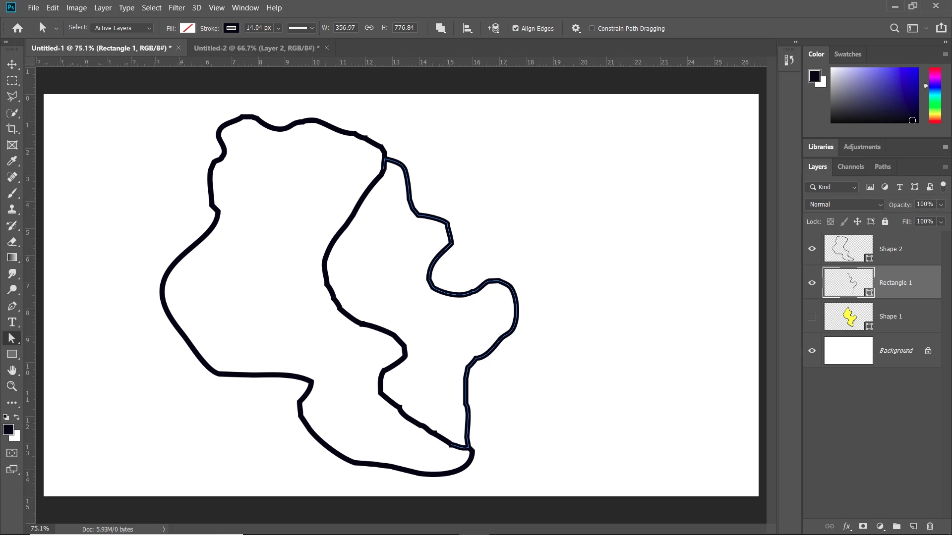

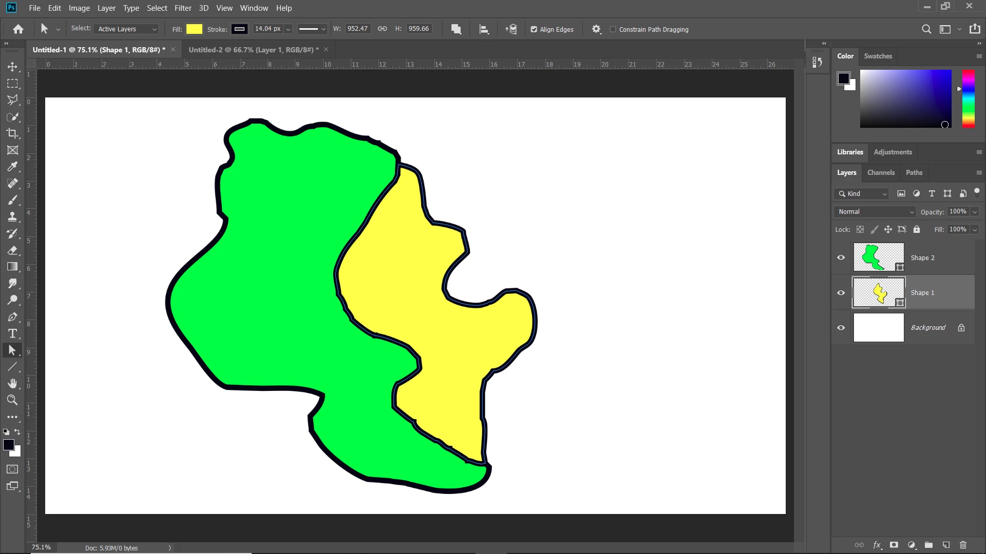

So here I have two layers representing two countries.
I use the direct selection tool to select just the outside border of the yellow country, and I pasted it to a new layer, or you can create a new vector, as you said, by using the freeform vector tool.
I turned off the fill of the vector layer and just have the strokes.
I can use the magic wand tool with sample all layers and select the region of the yellow country. Then I can expand the selection a few pixels so there is no white gap between the black lines that the fill. Then I can either fill a lower layer with pixels of my color choice, or create a vector from the selection and select whatever color I want.
This way you have upper layers with just the shapes or partial shapes of the countries, then lower layers with the colors.

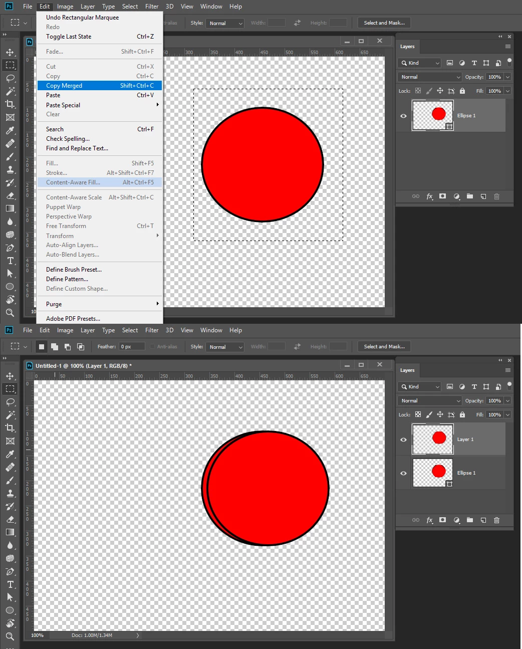

I just tried you would need to use Copy Merged to copy and past the pixels in a shape

I tried the Copy Merged method, that allowed me to make a copy of the base vector layer, however what I want in this instance is to cut the piece out. By copying I still have the selection remaining on the previous layer.

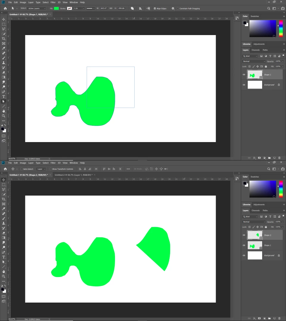

You can not cut and paste a vector layer with a selection, but you can select parts of a vector and copy and past those parts. So if your want to select part of a vector, you can use the direct selection tool to select either nodes or drag a rectangle around the area you want to copy and paste, as my screen shot shows. Frankly, for what you want to do, I would create a layer with just the country outlines, then use lower layers to fill those outlines.

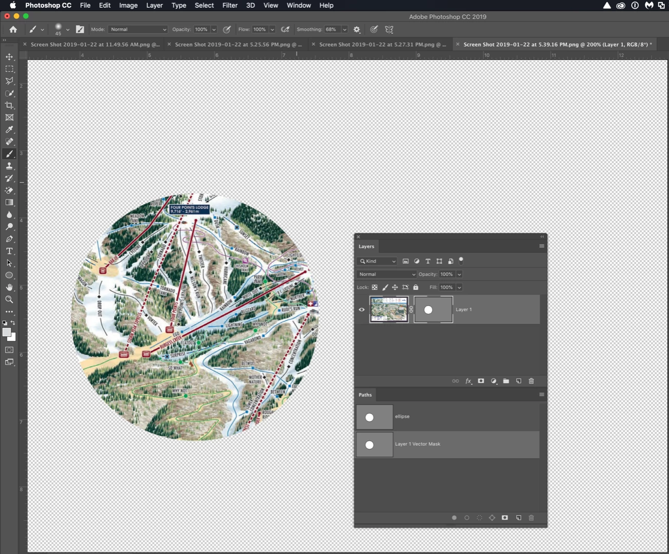

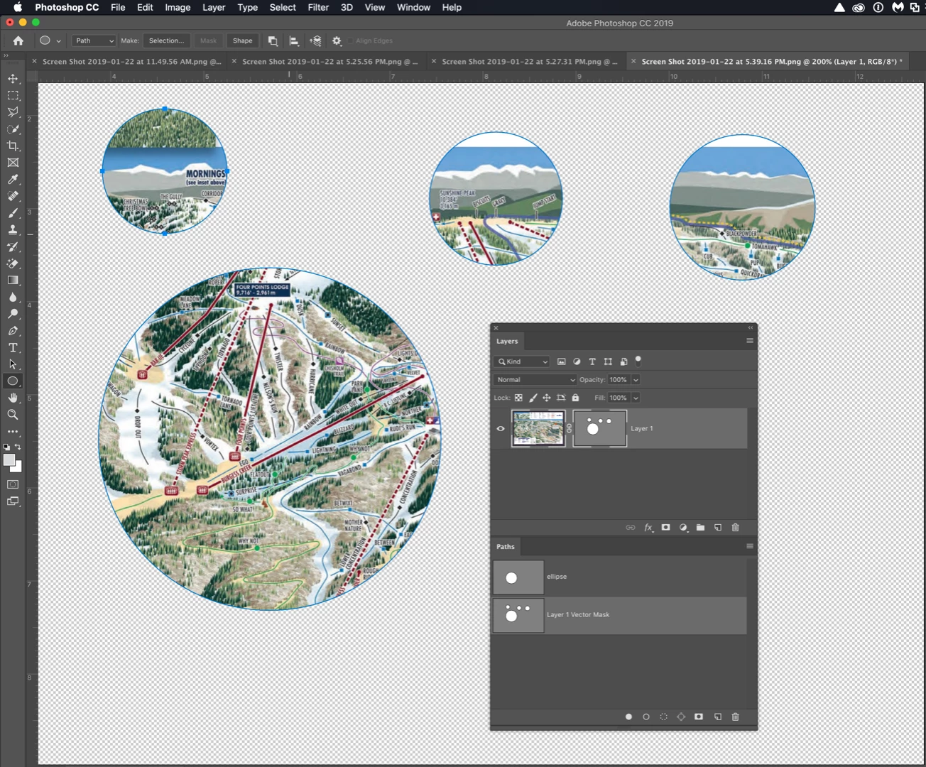

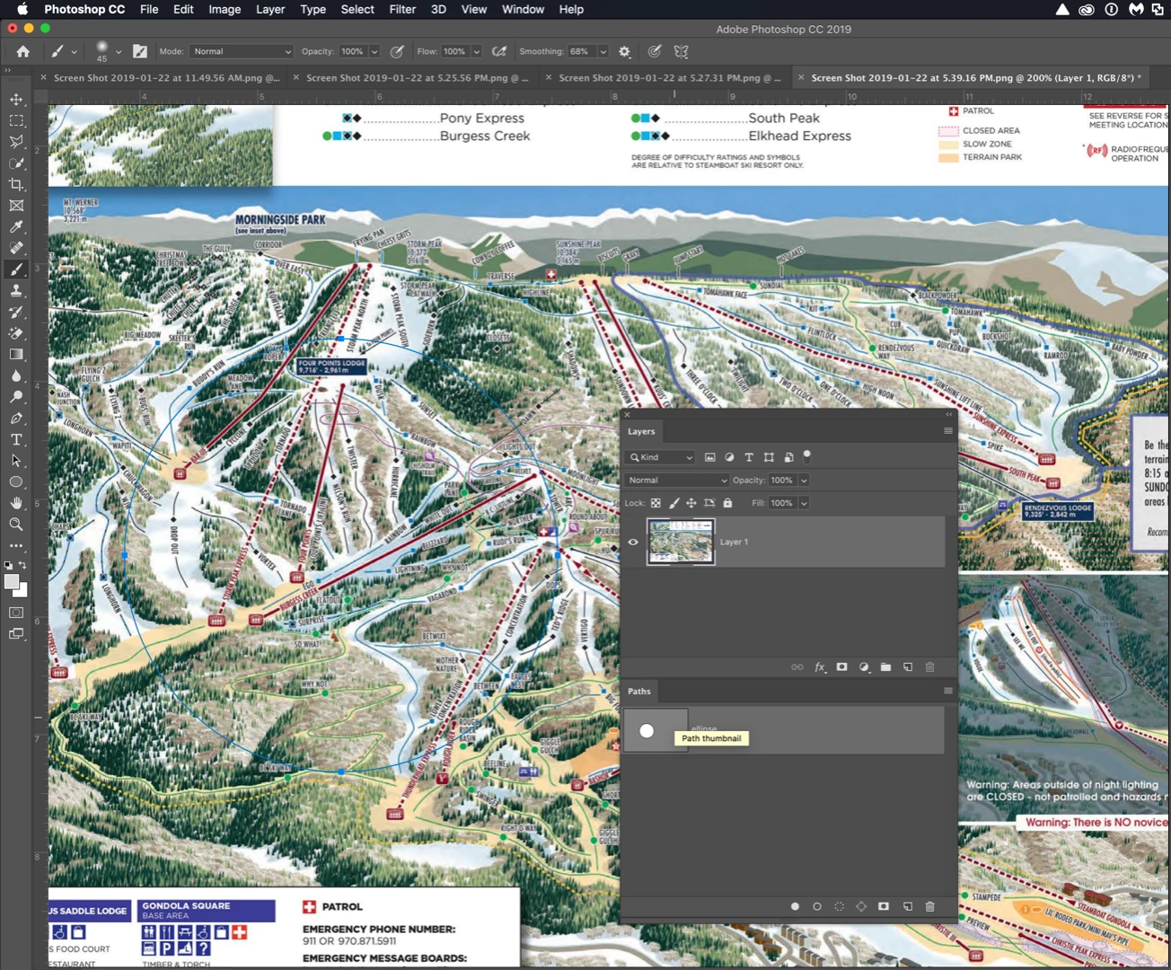

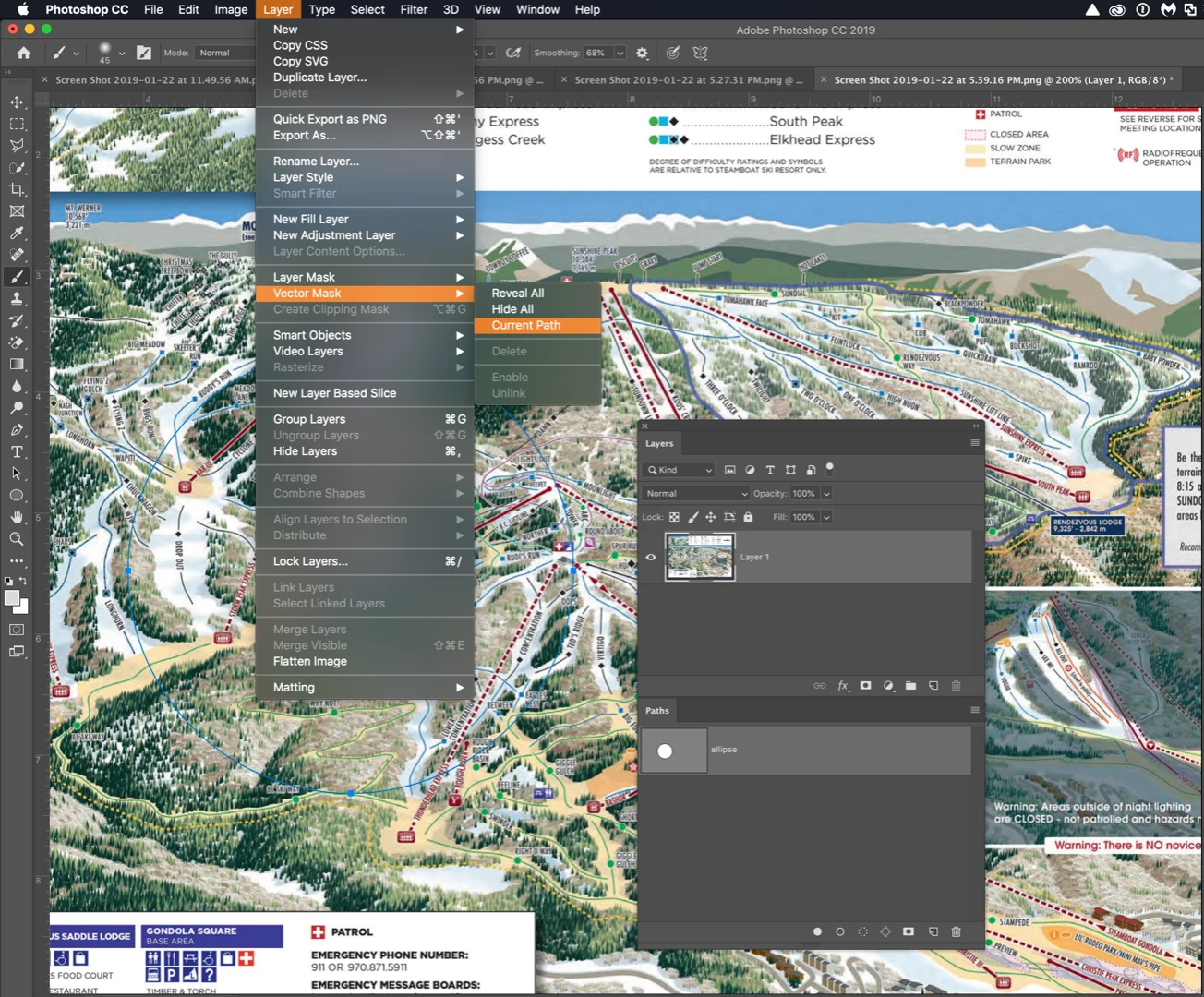

If I understand your question, then no. If you want to cut the raster map (or tree) into pieces you'll need to use raster selections and then jump them to a new layer (aka File > New > Layer via Copy or Ctrl + J). This is a raster option that does not work with vector layers.
You can use vector masks to mask the raster image underneath (and these are editable) so if you have overlap issues you can fix them.
  1. For example, I drew an elliptical path over this map.
2. I can create a vector mask of the current path to hide/mask the contents beyond the vector boundary.
4. And can add additional cut-outs to the mask.
But notice the whole raster map is still sitting on the layer. I can't use these vector shapes to carve up the map and jump them to their own layers.
~Barb
