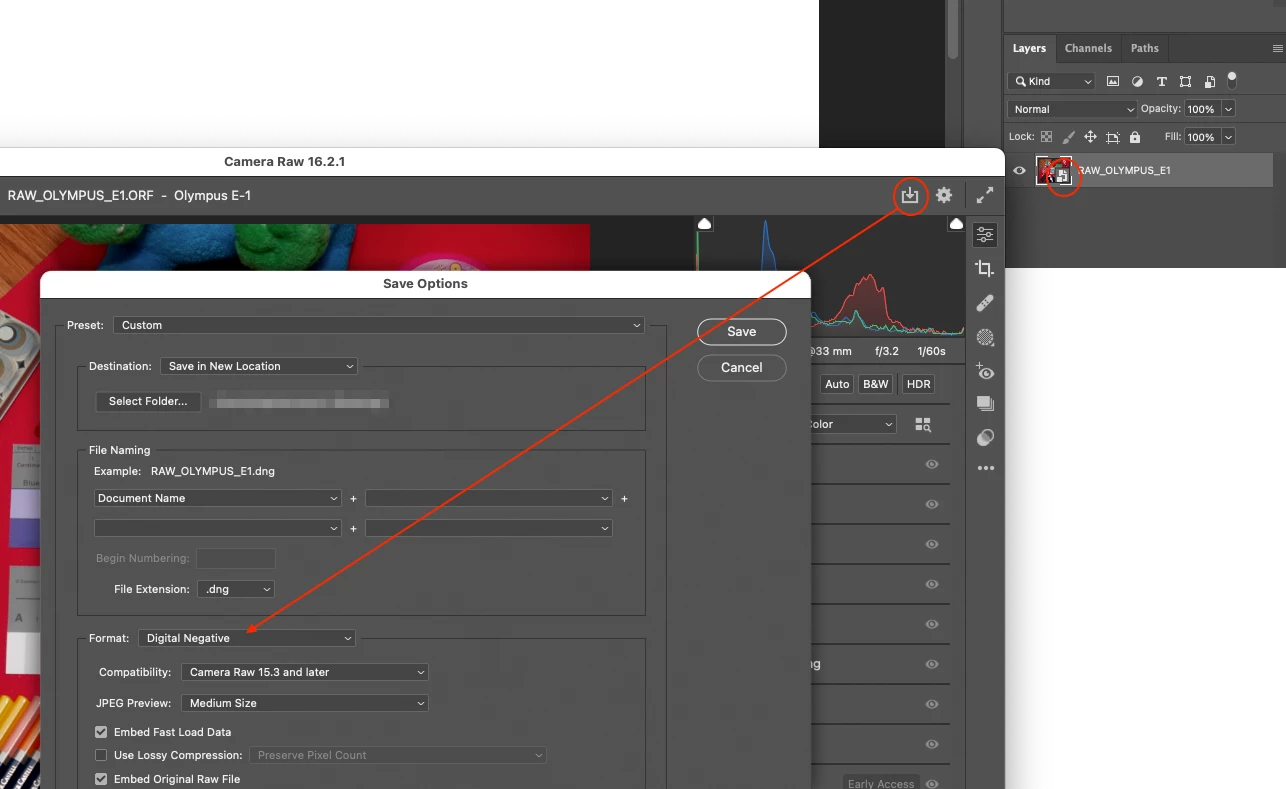

Anyway, I would suggest that you bypass Photoshop altogether, just open all raw files into ACR, select all the files and then export directly to JPEG from within ACR:
This screenshot is from another older post, ignore the fact that it shows a raw smart object and saving to DNG, the key point is that ACR has the "Save Options" button, the downward facing arrow in a 3-sided box at the upper-right of the ACR interface, which allows batch processing of multiple files selected in the ACR filmstrip.

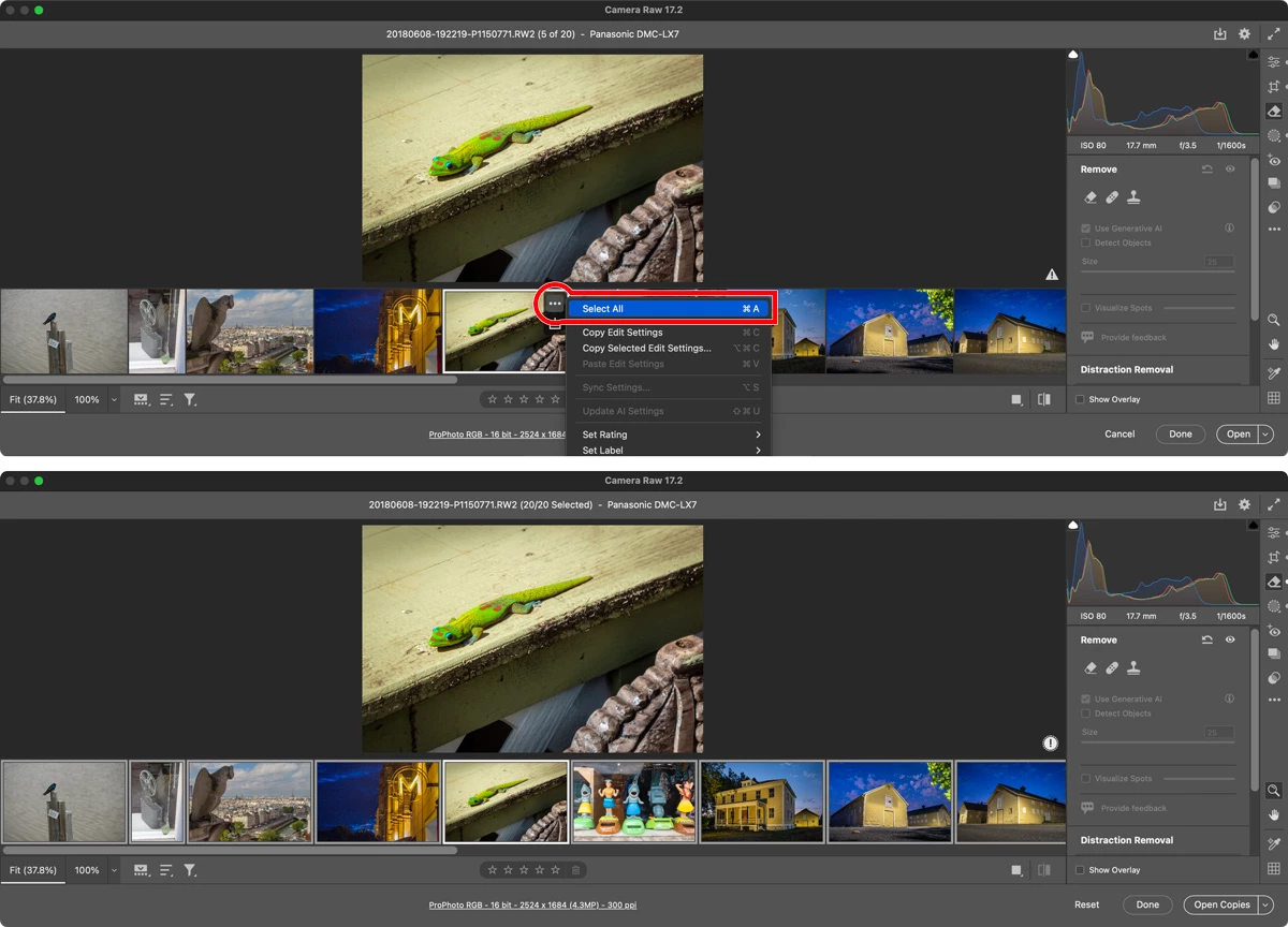

Ty - pls advise on the specific steps to do thsi with Adobe camera RAW, as when I open two images with it, the save process only saves the first.  Not sure how to get it to batch process.
Conrad_C
Feb 16, 2025 7:40 AM UTC
Stephen answered this a little earlier, and he’s right…the annoying thing about the Camera Raw method is that you have to select multiple files twice: First, in Bridge, to tell Camera Raw how many files to open, and then in Camera Raw itself after it opens, Select All must be applied so that all loaded files will be exported. (Obviously this is a feature, so that if you load 200 files into Camera Raw and only want to export a few, you can select just the ones you want to export.)
Select All is on the menu you get when you click the ellipsis (…) button that appears when you hover the pointer over any image in the Camera Raw filmstrip, as shown in the picture below. Or, you can get that menu by right-clicking any image in the filmstrip.
Notice the difference:
Before choosing Select All, in the top picture, only one image in the filmstrip has a thick outline indicating it’s selected.
After choosing Select All, in the bottom picture, all of the pictures in the filmstrip have a thick outline indicating they’re selected.
When you save/export from Camera Raw, the selected images are processed as a single batch. If you Select All, then all are exported.
Multi-image selection works the same as on the desktop:
To select a range, click one image and Shift-click another; all images in between are selected.
To select any combination of photos, Command-click (macOS) or Ctrl-click (Windows) images one after the other.
