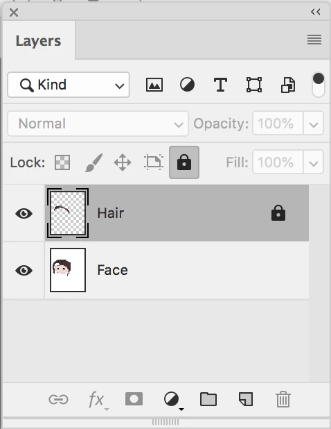

    jane-e
    July 22, 2019
    Dave, can you drag a locked layer to the trash? I can't. You can see the trash can is grayed out.
    (Drawing by "I.")
    ~ Jane
    davescm
    July 22, 2019
    Hi Jane
    Not to trash but you can drag to group or to new and by doing so create a duplicate. The OP said they could not do that.
    Dave
