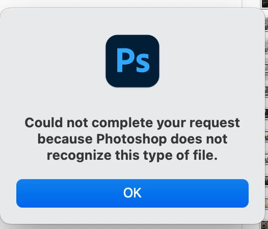

I have all my raw photos on a nas. i use an imac and a macbook pro m1.
on my macbook pro i can not open the files from the nas but have to copy the files to local folder to open.
on my imac i can open them directly.
i get this error message.
i have tryied to reinstall and delete all preferences and install it again.

@Morten5C06 wrote:
but have to copy the files to local folder to open. on my imac i can open them directly.
"Recommended workflow
"Technical Support strongly recommends working in Photoshop directly on the local hard disk. To prevent data loss, save files to your hard disk first. Then transfer them to the network or removable drive in the Finder or in Windows Explorer. To retrieve files, copy them in the Finder or in Windows Explorer from the network or removable drive to your hard disk. You can then open the files in Photoshop. This workflow avoids problems that occur when network system setups or removable media device drivers are incompatible with the operating system or Photoshop."
Please read this help file to see why Adobe does not support working directly off a network or removeable drive:
https://helpx.adobe.com/photoshop/kb/networks-removable-media-photoshop.html
~ Jane

Just reading up on NAS Drives, it might also be the type of connection. SMB is preferred over AFP on the M1s. This is a technical issue between your NAS model and your M1 mac, which might be best answered in a Mac NAS forums for whatever NAS make you have, or best worked out with their support.
Example:
https://community.roonlabs.com/t/mac-mini-m1-wont-see-nas-folder-synology/146647

This is a newer Mac OS issue - Apple does not recognize non-Apple formatted drives and causes this error.
You'll have to wipe and reformat to the proper drive format.

Sorry but no.
it is brand new format with OS X and if that was correct the issue would be on both computers not just the MacBook Pro

So you're running Big Sur on both the M1 and your laptop? Did you give Photoshop Full Disk Access in your Mac security preferences?
