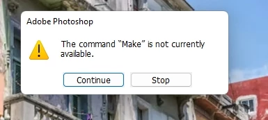

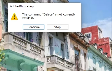

I've installed a Watercolor Artist Action Set but couldn't run it because I got 'The command SELECT is not currently available. And it showed again with DELETE, CONTRACT, MAKE, STROKE, ...
I don't know what to do now. Please help.

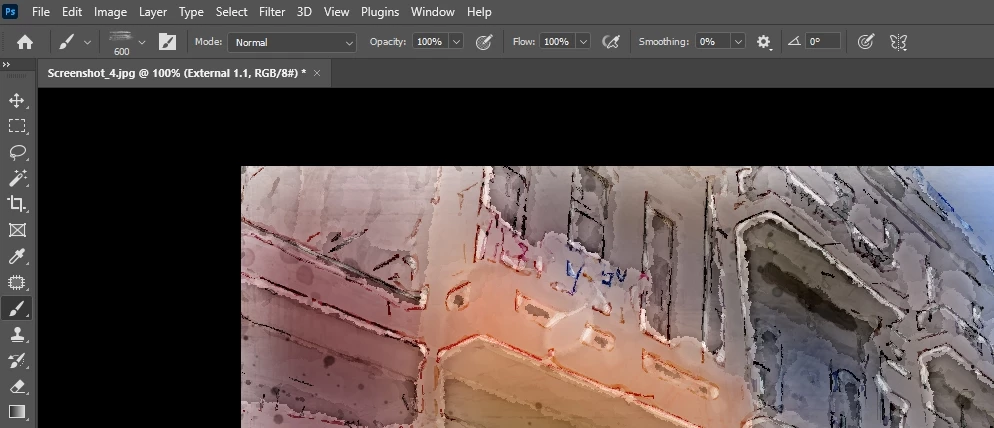

Could you please post screenshots with the pertinent Panels (Toolbar, Layers, Actions (with the expanded Action at the point of failure), Options Bar, …) visible?

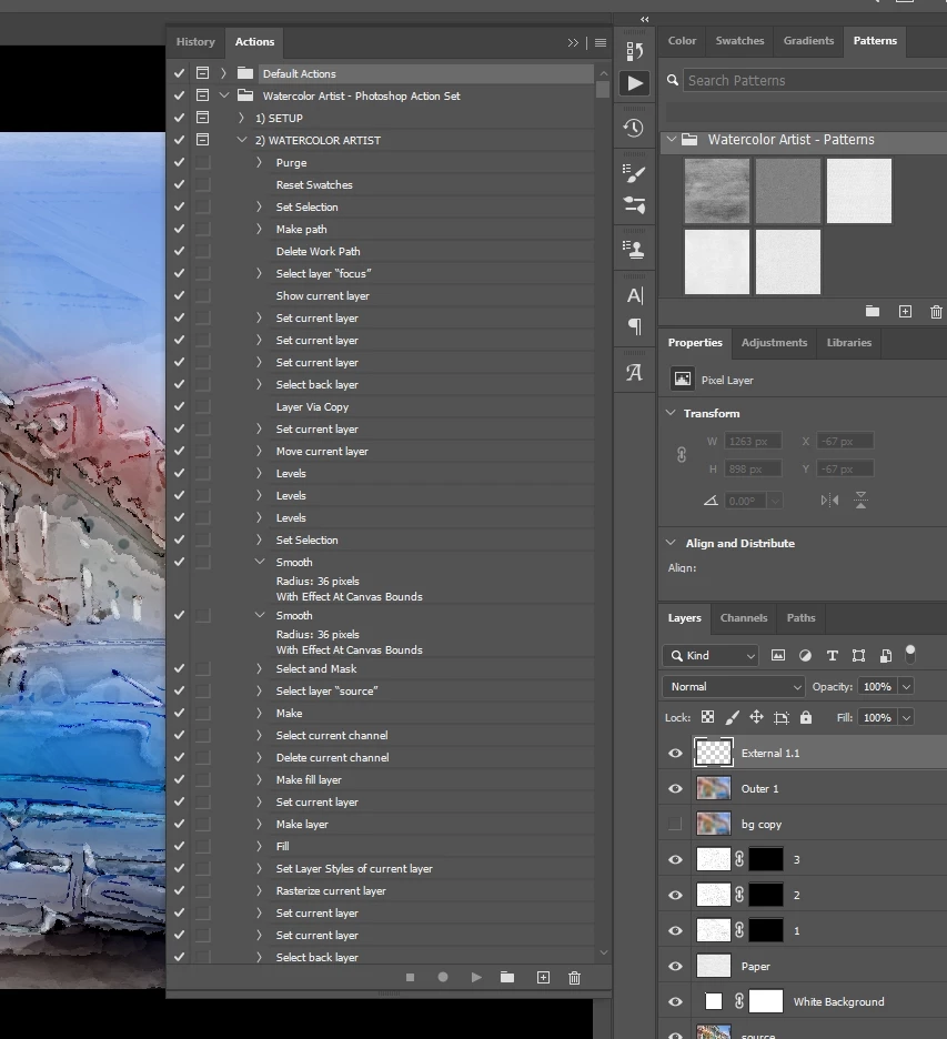

Could you please post screenshots with the pertinent Panels (Toolbar, Layers, Options Bar, …) and the expanded Action in the Actions Panel visible?

Please shoot the whole screenshot (the Layers Panel and the Actions Panel should definitely be visible) at the moment of the error.
That way it should be possible to see which step in the Action trips up and which Layer is selected at that time.
In the screenshot the active Layer (»External 1.1«) seems to be empty so it would be important to know what was supposed to happen.
