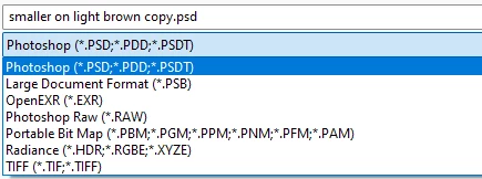

Please confirm if your document is/was set to Image > Mode > 32 Bits/Channel (the clue was that your save dialog was showing HDR formats).

Ok, I already have saved my work in psd format, I want to save a copy of the same in jpg and the drop down does not give me the option.  Here are the only options:

You either need to use Save a Copy or setup Legacy Save As in your File Handling Preferences.
JPEG is a restrictive format, it doesn't support layers, alpha channels or bit depths higher than 8 bits per channel (bpc).
It appears that you are using 32 bpc mode. If so and you wish to keep this, then you will need to duplicate the image, select 8 bpc mode and tone map (HR toning) as required. 32 bpc is an exception, if using 16 bpc Save a Copy or Legacy Save As would have JPEG available as going from 16 bpc to 8 bpc doesn't require tone mapping and can be automated without human intervention.
