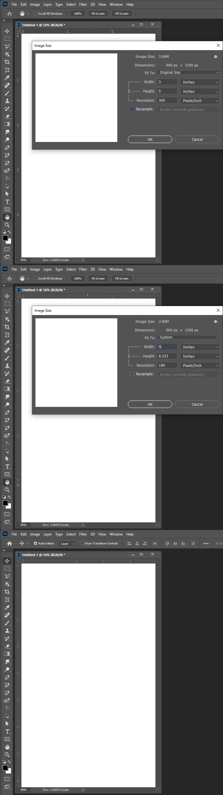

I'm quoting a job that is 300 dpi at 3"x5" size but client wants it to print at a larger size (5.5”x7” or thereabouts). I’m concerned about loss of resolution if I print it at a larger size.  When I look at the specs for a larger size of this image in PS it’ still shows 300 dpi.

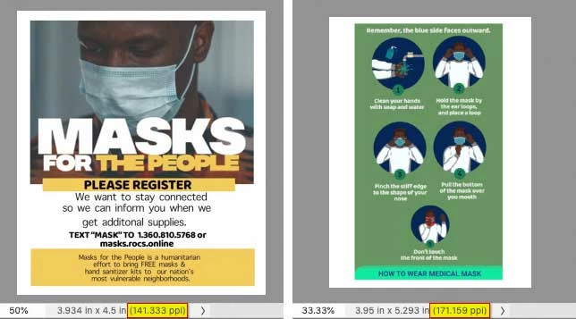

I had Acrobat open the PDF you attached, and had Acrobat pop open the embedded images in Photoshop. This revealed several problems with the attached PDF:
  • Photoshop says the two embedded images are far below 300 ppi to start with (highlighted at the bottom of the graphic below), so the type in the PDF is already not 300 ppi at print size; it looks fuzzy.
  • The reason the type is already not sharp is that the type was rasterized into an image. There are no editable text layers. If the type had been left as original text, it could have been scaled freely, but in its current pixel form it won’t scale well.

Also — if you used Image Size in Photoshop to preview scaling it up, and it said it was still 300 ppi, that’s probably because the Resample option was turned on. When Resample is on, Image Size will maintain or increase the resolution by “making up” additional resolution from the existing pixels, but that never looks as good as having full resolution graphics in the first place. If you want to see how ppi is really changing as you scale it up to 5.5" x 7", turn off Resample.

Set the print resolution around 180 to 190 DPI or change the height or width to the size you want and Photoshop will set the other side and dpi in the image size dialog with RESAMPLE NOT Checked.
