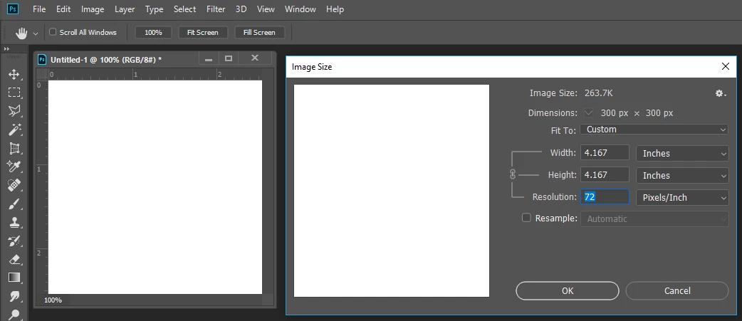

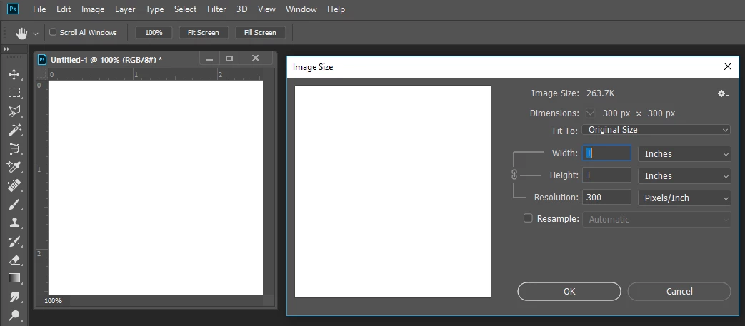

DPI is meaningless on the web.  Displays devices do not us ant DPI setting. They can not change their Pixel size the use the Pizels size they are manufactured with.  You web Image will be seen at various sizes.  Size depends on the Devices they are being display on.  On the web you just  care about the number of Pixels you save your images with,  X number of pixel wide y number of pixels high.  Save for Web does not save any DPI setting.  If you open a save for web image in Photoshop.  Photoshop will default its resolution  to 72.  You can change that to any setting you want  the image to have.  Un-check and set the DPI  Print resolution you want.  All that will change is the Image DPI print setting.  Not a single Pixel will change.  A Inch Unit is relative to resolution.  DPI Resolution is Physical Print Pixel size.
300Px by 300 Px at 300DPI is 1" x 1"
300Px by 300 Px at 72 DPI is 4.167" x 4.167"
The Pixels are printed a different size
