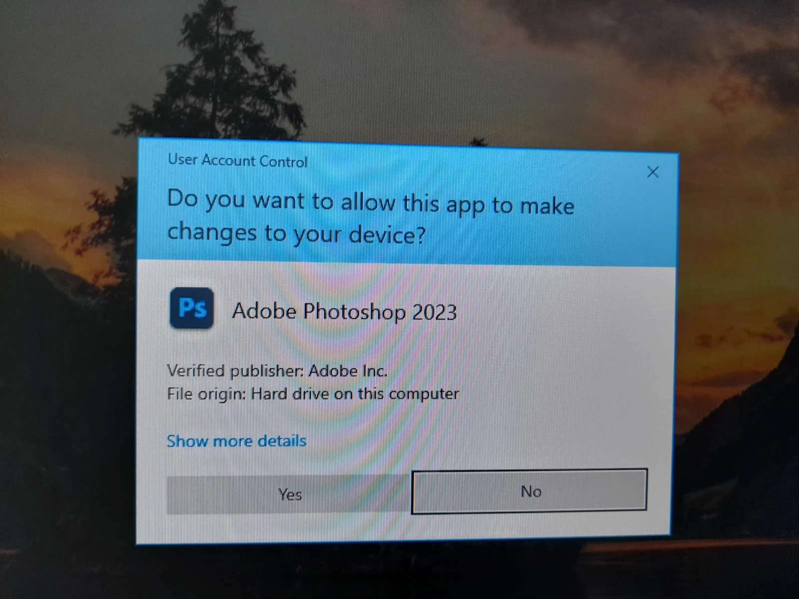

Hey @Sameer K thanks for your time and solution to my problem
you've provided solution with two methods
first one did'nt work the second one did work out for me and getting a type of notifiation everytime i open photoshop ( jpeg attached )
and as you've asked to share system info, i'm attaching info in both pdf format as well as doc format.
Once again thankyou for helping me with this issue.
But I really want to know what's the issue with the updated version.
Please do let me know.
