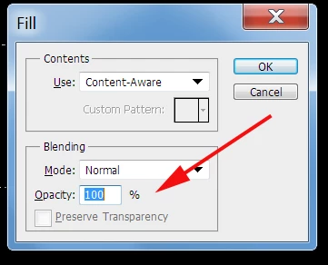

    August 13, 2012
    This might be a little late. I had the same problem and I found that in the fill dialog box the opacity was on set at 1%. Change this to 100% all ok!

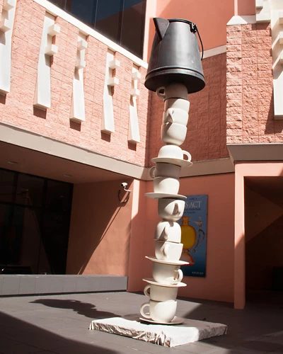

    April 2, 2012
    Not exactly sure what is meant by copying the areas to a new layer, but I tried it...didn't work.
    This is the procedure I use which I developed by taking notes from tutorials I have watched:
    Select object (the cups and pot at top) and save to new channel.  In channels tab, Cntrl-click to load selection.  Click on RGB channel. Choose Selection/Modify/Expand and expand selection by about 20 pixels.  Edit/Fill with Content Aware.  Deselect.  Fix as necessary.
    Heres the image (see below) I'm working with (I want to remove the cups...in preparation for Puppet Warp procedure which I will use to bend them):
    CAF is bringing in the white rectangular objects jutting out on the left side, bricks on the right corner, the sign on the bottom, etc., etc.
    Thanks for the help.
