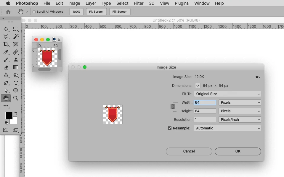

There was a reason why I asked about the resolution …
Why 1ppi?

Not sure. I got this image from a paid sprite pack. It's wierd that I was able to drag them in just fine at first, and then it started giving me an error in the middle of working on a project.
c.pfaffenbichler
June 6, 2021
What was the resolution of the image into which you could place the images without problems?
Changing the Resolution (without resampling) to a meaningful setting (ideally the same as the receiving image) should help.

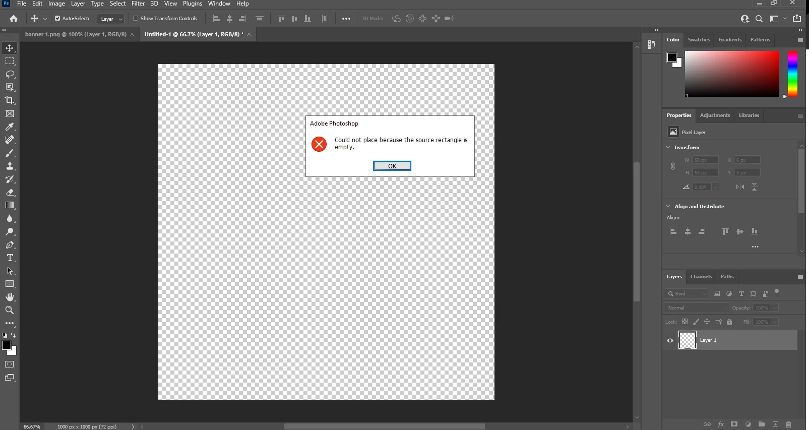

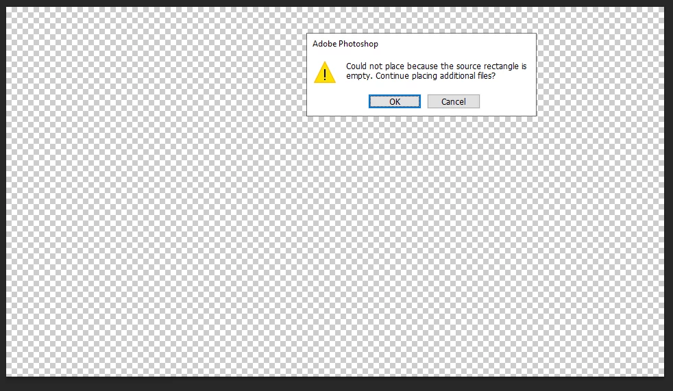

June 1, 2021
I have attempted deleting preferences on exit, restarting photoshop, and restarting my computer. Here is the error stack for the particular error. Also I have attached a screenshot of the whole window, and one of the files I am trying to place.
Photoshop Error information
Code: -25670
Text: because the source rectangle is empty
Message: Could not place because the source rectangle is empty.
