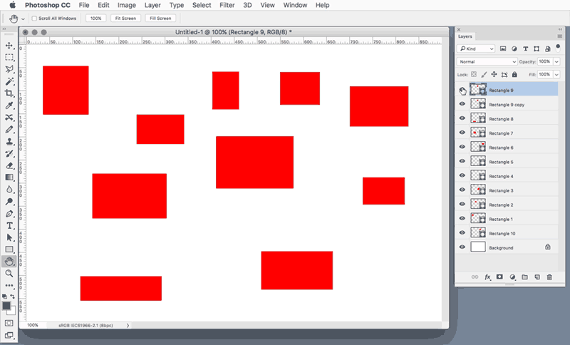

I can't seem to scroll through the layers by pressing Alt + [ or Alt = ].
I'd read online that you could scroll through the layers revealing only what is on the layer. All other layers are hidden.
Can anyone help?
Richard

Hello, Richard, are you using a US version, with a US keyboard?
Also, indeed, you just need to have a single layer visible, as Chuck showed it.

First Alt or Option click on the Eye for the selected layer to hide all other layers, then Alt or Option +[ or ] to cycle down to the next layer, turn on it's visibility and turn off the previous layers visibilty and so on.
Chuck Uebele
October 15, 2019
If a layer is not visible, this method will skip over that layer. It will also skip over layers in a layerset that is collapsed. Other than that, it is working for me. You might need to reset your preferences if it's not working for you.
