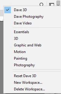

Hi
I create my own custom workspaces.
Get everything the way you like it and click New Workspace . Then name it. I set up one for photography, one for 3d and one for video. That way I can quickly switch and know the panels and toolbar are set the way I like them, not the way someone else decided to make them.
Whilst you can change the existing spaces, if you reset them they go back to Photoshop's layout. Resetting your own goes back to the way it was when you created it.
Dave
