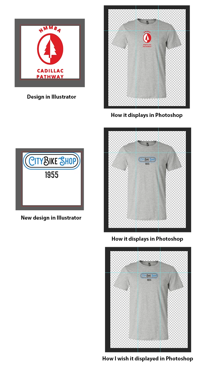

I am using Photoshop 2020 for a lot of t-shirt mock ups. I am linking (linked smart object) designs in Illustrator with the t-shirt images in Photoshop. So if I change the design in Illustrator it will change on all the t-shirt images in Photoshop. That's working fine. The problem is that the reference point in Photoshop seems to be in the middle of the design. So when I change the design in Illustrator and it is a different size than the previous design I need to go and move all the designs around in Photoshop to be in the desired spot on the t-shirt. I would like to change this reference point to the top of the design. This would eliminate me from having to move all the designs around.
Is there anyway to do that?

Here's an example of what I'm trying to do.

The designs are different sizes in Illustrator. The artboard is the same size but the design itself is different. What I'm trying to change is the default center reference point to be aligned at the top of the image.
