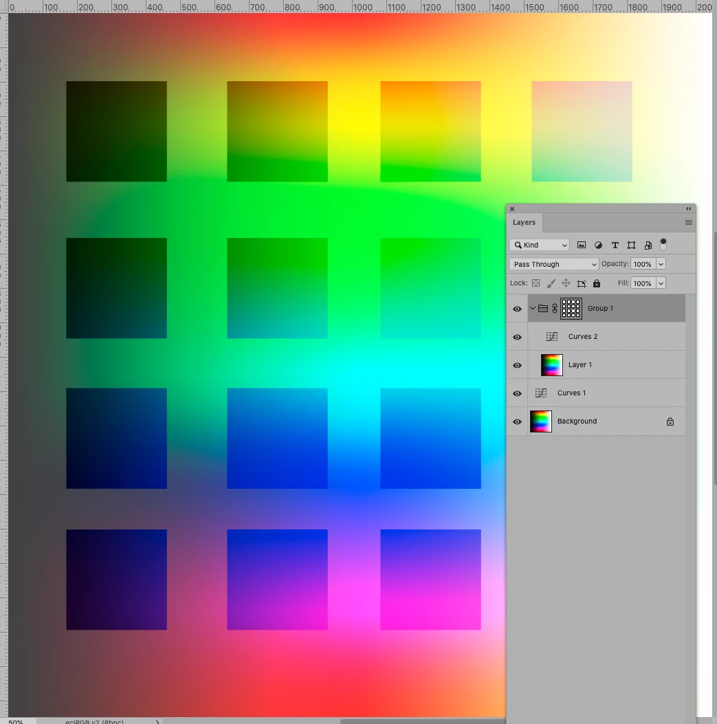

c.pfaffenbichler
December 28, 2020
Or, to avoid the hassle of having two Layer Masks/Vector Masks, group a duplicate Layer with the corresponding Adjustment Layer and apply the Vector Mask to the Group.
