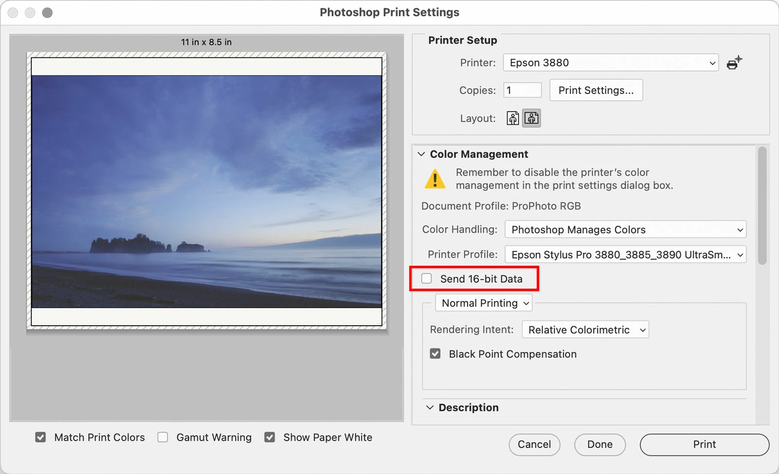

Not only is it fine to send 8-bits per color to a printer, but a few printers that actually accept 16-bit data in the print path (a few Epson's with the option in the driver) also have over the years been rather buggy and produce butt-ugly output unless the check box is off
No need for it to be on, good ones not to be on.
The check box in Photoshop seen earlier doesn't ensure 16-bits will be used; it is a function after this of the print driver.

If you have a 16bpc file and you’re sending it out to be printed, you follow the file specifications the printing service requires. So if they require an 8bpc JPEG file, you convert it to that.
If you’re printing directly, you don’t have to convert the file for printing, because Photoshop can do it on the fly for you. If the printer driver is one of the few that can receive 16bpc files directly, then in the Print dialog box in Photoshop, the Send 16-Bit Data option will be available and you can select it. However, you should know that many printing experts say it’s hard to see if Send 16-Bit Data makes any visible difference, maybe in part because of the limited dynamic range of print. So I leave it disabled.
If the printer driver can’t handle 16 bits per channel files directly, or if the file is not 16bpc, then the Send 16-Bit Data option will be disabled, and the file will always be sent at 8bpc.
Selecting Send 16-Bit Data sends more data, so it may take longer to print, and may require more free storage space for the temporary spool file.
