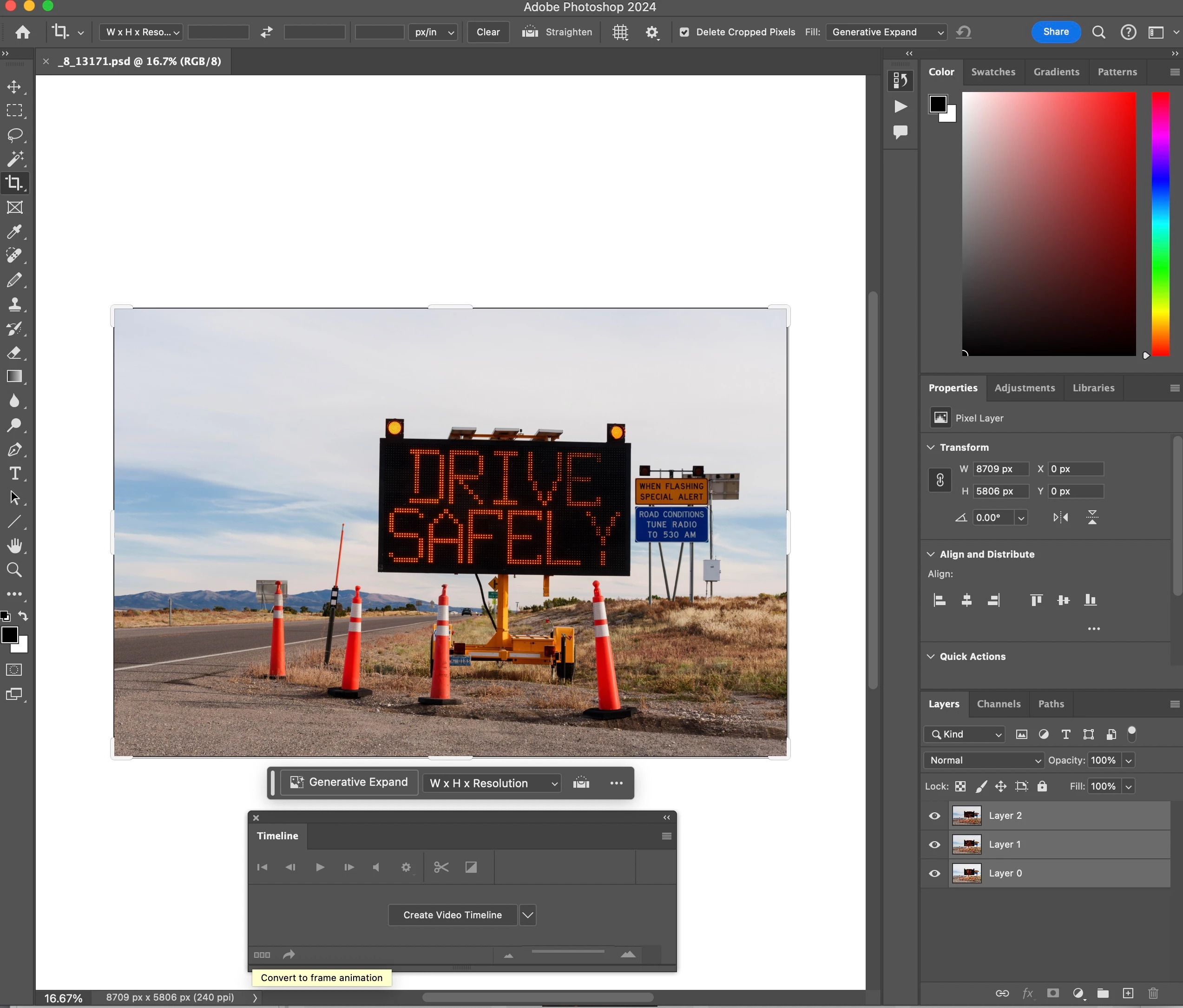

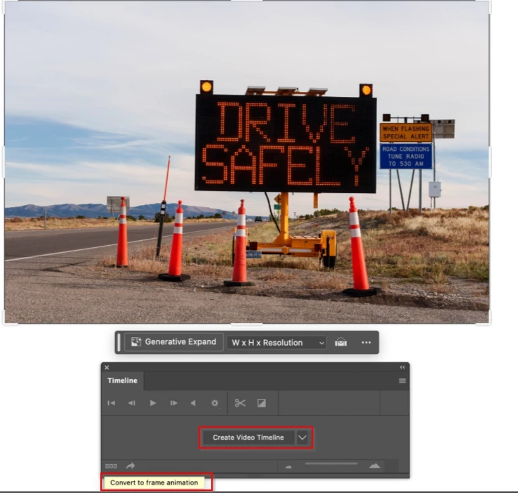

I am trying to make an animated GIF in Photoshop following the instructions in https://www.adobe.com/creativecloud/photography/discover/make-a-gif.html. However, after opening the Timeline window, I cannot click on the "Create frame animation": when I hover my mouse over the three squares at the bottom left corner, the cursor turns into a crossed circle. Both 2024 and 2023 versions of Photoshop on Mac OS 12.4 exbibit the same issue. How can I fix this issue? Thanks.

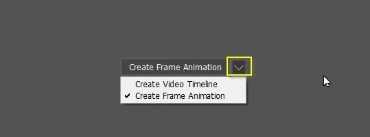

In the time line use the drop down and change it to Frame Animation.
Click on Create Frame Animation  which will create your first frame.

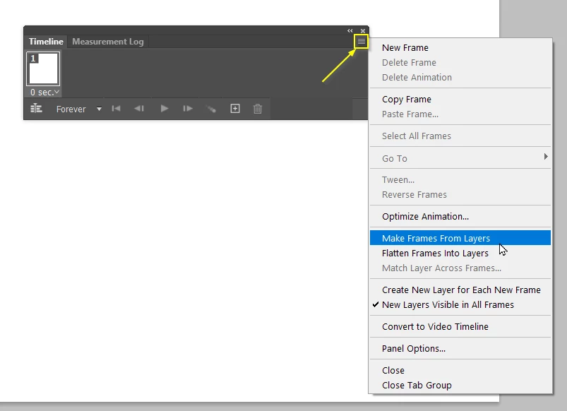

In the pop out menu in the top right corner of the timeline, click on Make Frames From Layers.
You are nine tenths there then, but you might have errant frames like the background layer that you'll need to create.   You might have no background, in which case, if it is white, don't worry about it.  If it is an image, you'll need to select all of the frames (Click on the first frame and Shift click on the last frame) then turn the image from on.  Don't forget that it need to be at the bottom of the layer stack.

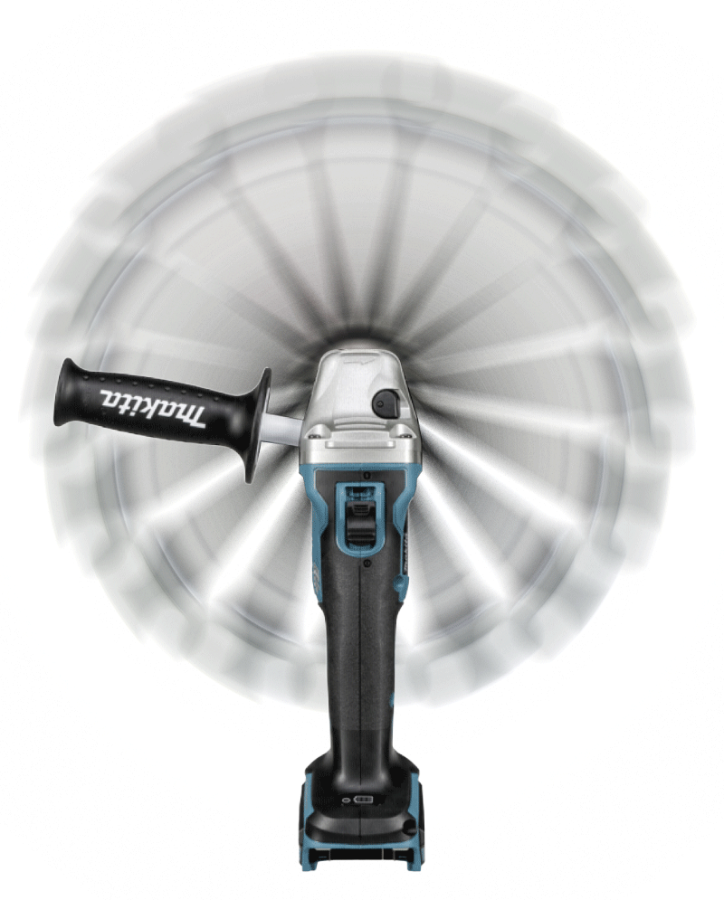

As already alluded to back this thread, frame animations need to have small file sizes so the most I would normall work with is 1000 pixels square, but a bit more if you have just a few frames (say ten).  You can make them work with hardly any frames.  This one from the current Something For The Weekend thread has just two frames for instance, because each frame only has to rotate half way to the next spanner and the movement is concentric.

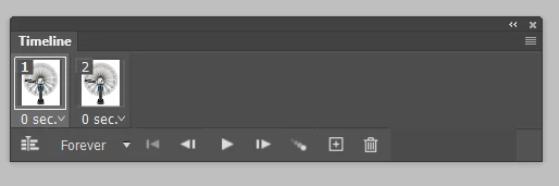

Have a play with Tweening. In its simplest form, you start with one frame
copy the frame and move the object
Select both frames and use Tweening to create the steps in between.  These can look very jerky so we might blur each frame to minise that.

First off, what is your workflow here?
We can't see the entire timeline in your screen shot, and what we can see is Create Video Timeline.
Under that we can see Convert to Frame Animation
How exactly did you arrive at this state?  Are you starting with a video file? I am pretty sure that your timeline must be empty at this point, so I am not sure how the Convert to Frame Animation pop up was prompted.
In my experience, using the convert to frame animation feature only creates a single frame from a video, and I have never needed to work out how to do it properly.  You can convert frames to layers, (by using Convert to clips) but it will create maybe 330 layers for every second of video, and is a VERY impracticle workflow.
I've got to go so explane how you got to where you and between us we'll get you sorted.
qtluongAuthor
October 24, 2023
I followed the steps described in the link, which means that I opened an image file with layers (not a video file). The "Convert to Frame Animation" popped when I hovered the cursor over the three squares. However, at that point the cursor turned to a crossed circle (which was not recorded by the screen capture), so I could not click and activate frame animation.
