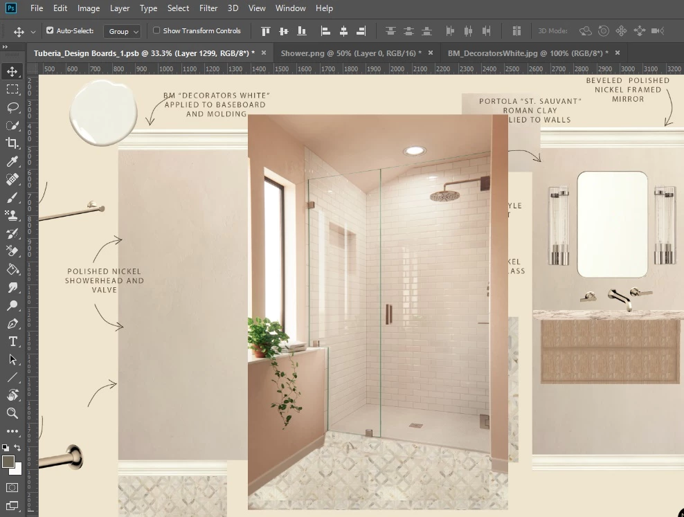

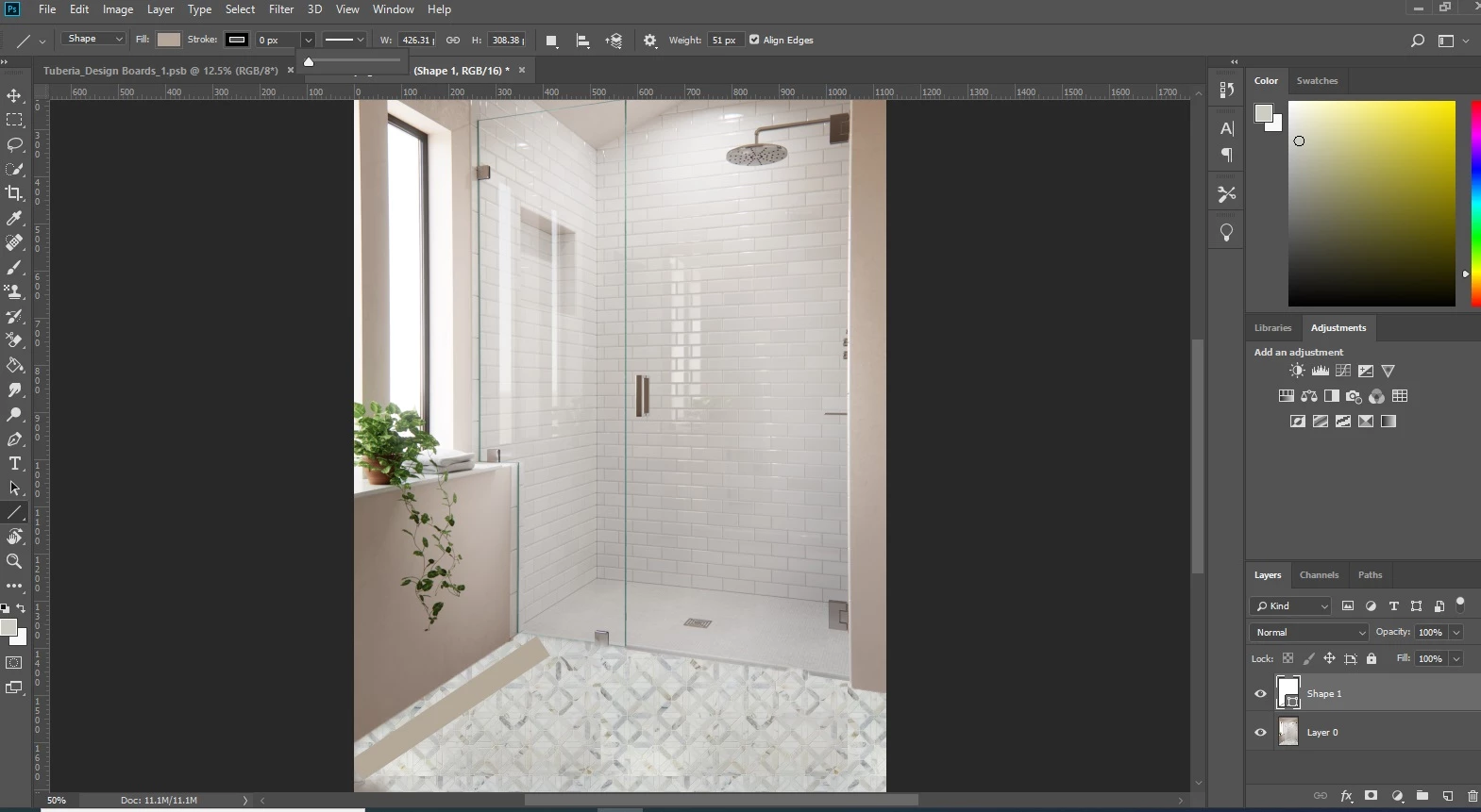

I cannot believe how difficult Photoshop makes it to draw a simple straight line and then adjust the line weight. In the attached screenshot, I am simply trying to draw a line where the baseboard meets the floor to distinguish the adjacent materials after I have applied a tile pattern.

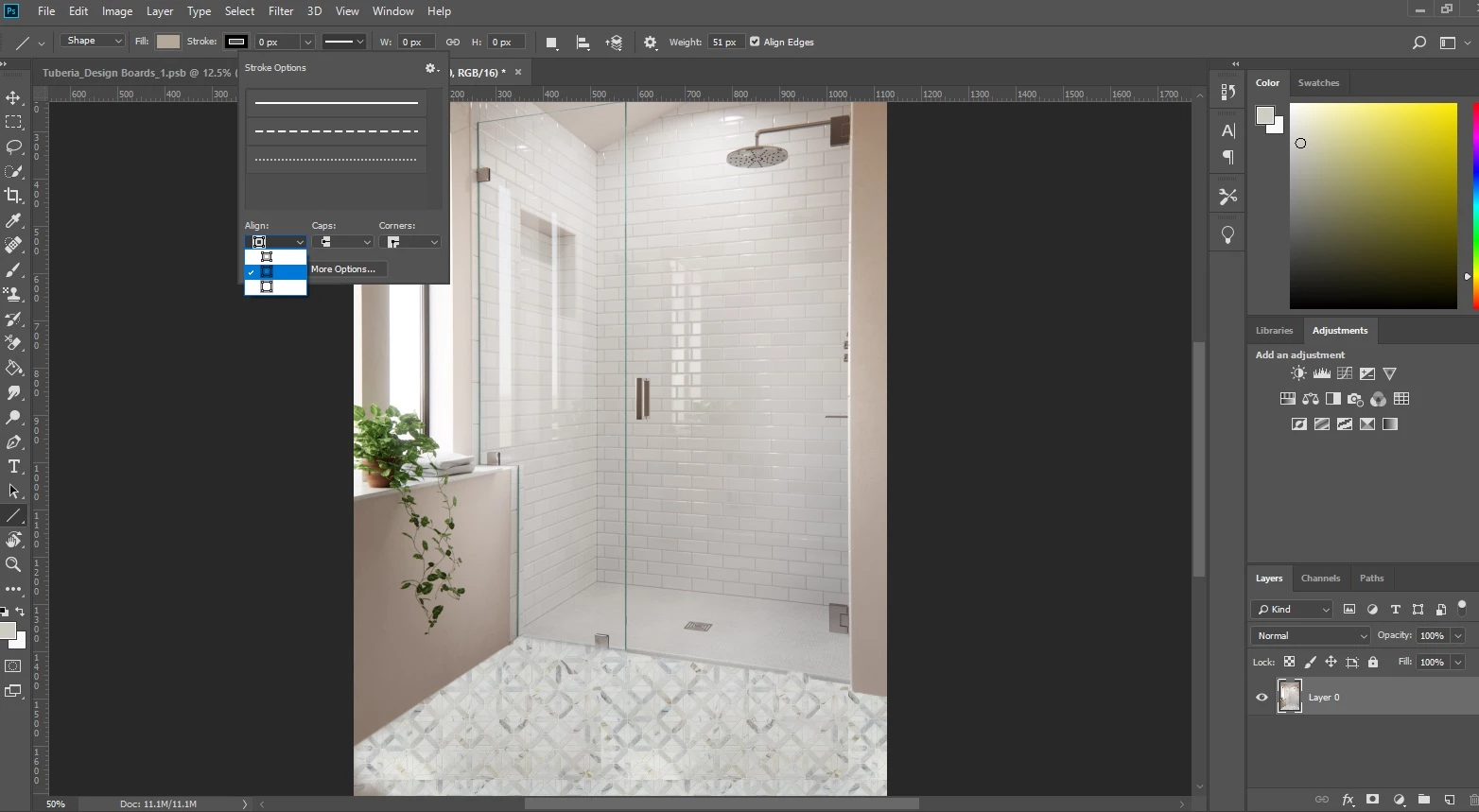

You can see in the toolbar in both screenshots, that no matter which line weight I enter, the "line" stays the same rectangular shape. If I adjust the line weight higher than 1, I receive an ugly black border around it, along with an additional blue line in the middle, but the line weight itself doesn't adjust. I have tried adjusting the Linetype amongst all the options - Shape, Path, and Pixels, and receiving the same result. My Alignment is set to center as screenshot #3 reflects. Just to repeat: All I want to do is draw a subtle grey thin line that resembles grout to illustrate where the floor ends and the baseboard begins.

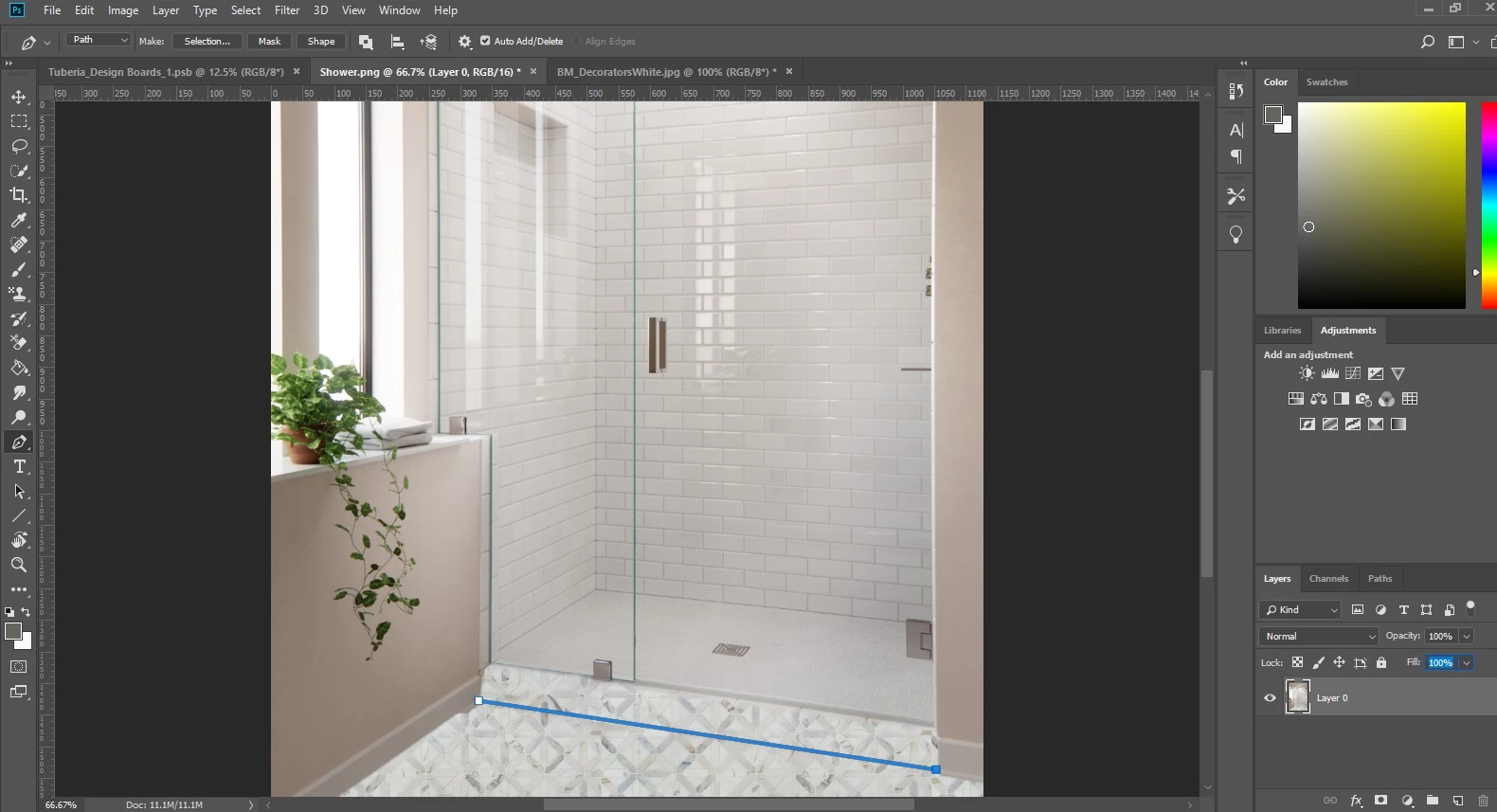

Thanks but Pen Tool doesn't really seem to solve my problem. Ideally I hould be able to select and control the line weight (I am refering to "thickness" when I say "line weight"). Also I can't seem to select the color of the pen tool, it stays Blue and there doesn't seem to be a property that allows me to change the color. Screenshot attached. How starnage PS defaults a line from Pen Tool to a Blue color? Do they expect users will need to use Quick Select tool to highlight the line and and then color match to a new color opened in a seperate tab?
Lastly, when I click in the Pen Tool boxes to close the path and then move the image and all their layers into an existing artboard, the line completely dissapears. It appears the layer is only visible in its own tab, but that effects cannot move to new Artboards?

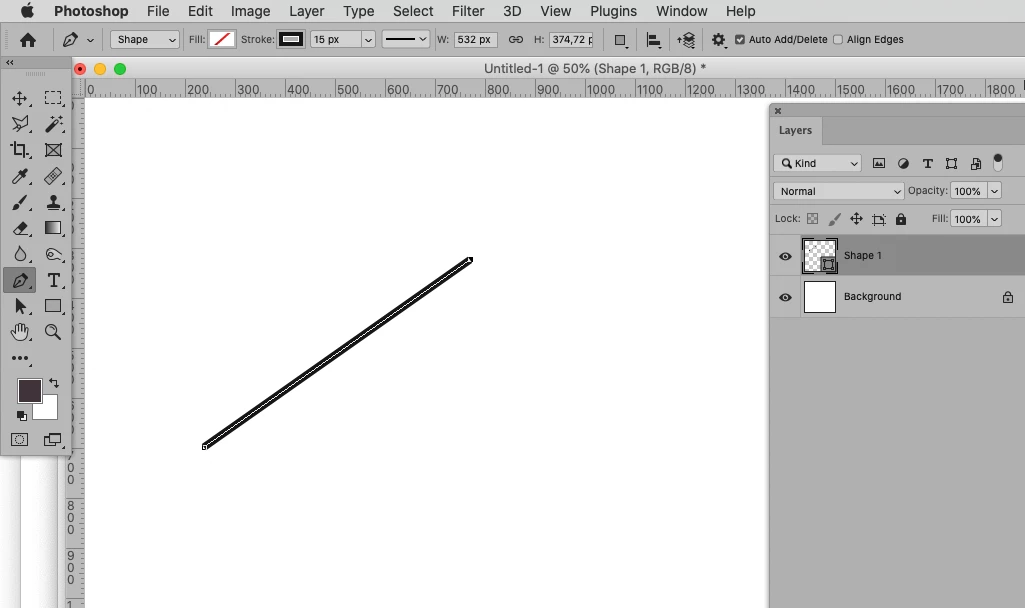

c.pfaffenbichler
February 21, 2022
Set the Pen Tool to »Shape« (in the Options Bar) and set the intended Stroke.
Then clicking two times in the image should create a »line« with the corresponding Stroke.
