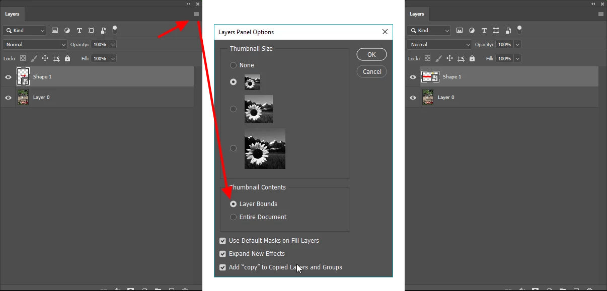

By the way after converting object to Smart Object layer you may be confused by what you see as thumbnail in the Layers panel. To see only layer bounds click on Layers panel menu > Panel Options then change in the Thumbnail Contents to Layer Bounds.
