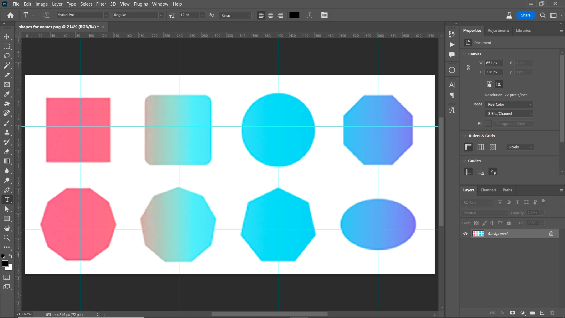

Try this script. You have to do some setup first.

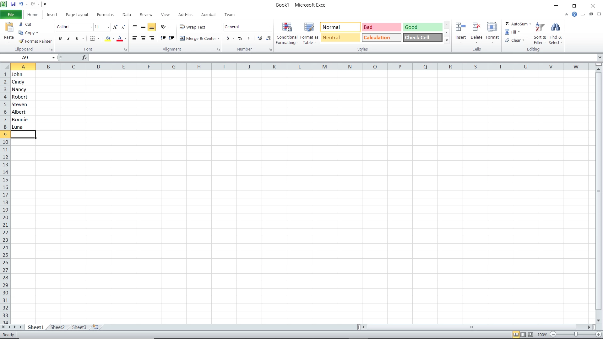

1. Create a folder on your desktop named "Names in Shapes".
2. Create a spreadsheet file with the exact number of names as you have shapes, and put all the names in one column.
3. save the spreadsheet as a csv file to the Names in Shape folder on your desktop.
4. Open your image file and put guides across the shapes (they don't have to be centered, they just have to go over the shapes.
Run the script.

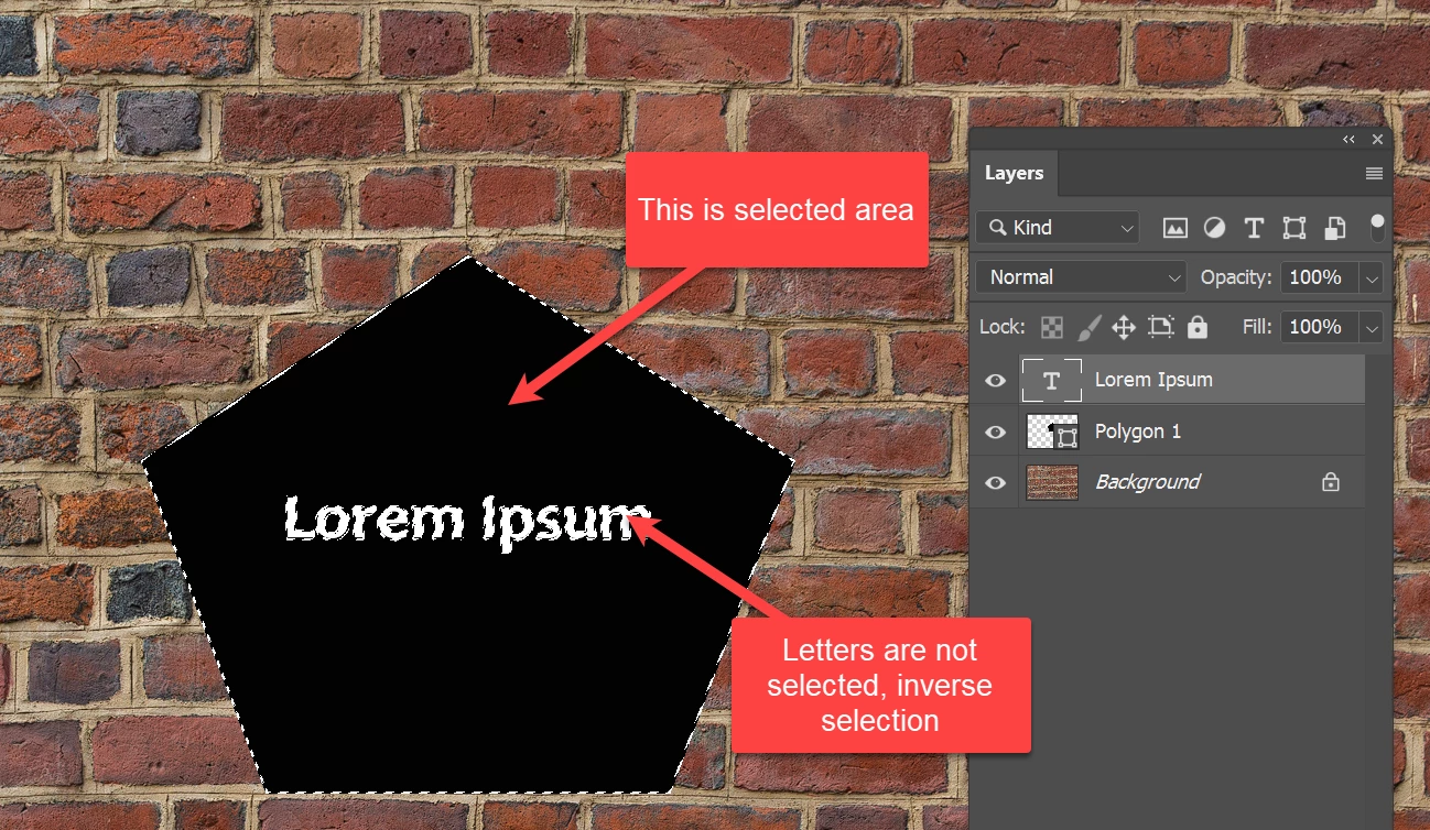

Bojan Živković11378569
November 25, 2022
Can you explain your problem further. I would like to understand your problem in the first place. At the moment I can not follow nor understand what is actual problem:
"Such as an action or script that automatically selects the area outside the text while also being inside the shape?"
First of all do you want to select text inverse while staying inside boundries of shape to which text ois aligned?

November 24, 2022
Sorry to say no, I use the provided vector image as png. Actually I need this action/script for other things too, like placing text layers in the center of text boxes in series of illustrated story pages (The boxes are arranged above or below the illustrations, I can't control them all)
Or you can help me create operations for each text layer, just skip the step of selecting the shape area. I can run for each text one by one.
Imaginerie
November 24, 2022
There are probably many ways to do this (with scripts for example) but one solution would simply be to use guides and snapping and let the text align by itself while moving it.
Since your shapes seem to be aligned in rows and columns, you could set up guides that cross each shape right at the center, and provided you enable snapping, your text will snap at the intersection of these guides for each shape.
If you know how your shapes are laid-out (eg: how many pixels separate them top bottom and sides) you could even build yor guides using the guide layout menu. This is particularly helpful if you are to use this kind of layout repeatedly.
That's a quick and dirty method which is, of course, not necessarily the most automated one.
But it may help...
